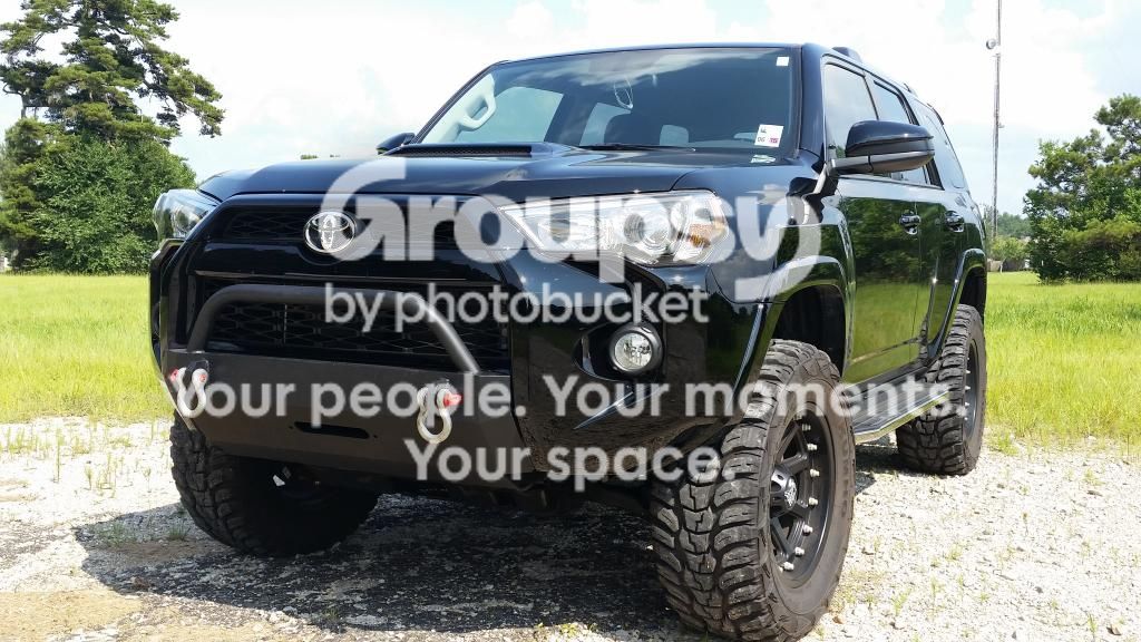

Got my full sized spare finally; apparently there was more wiggle room than I thought would be possible to fit a 33 inch tire. I went with a Cooper ST MAXX LT255/80R17 inflated to 45 psi which measures 32.8 inches tall but only 10.2 inches wide; the tire fits right on the spare rim and is tucked up nicely. It was a great match for the Cooper ST MAXX LT285/60R17s which are right at 33 inches tall. Thanks [MENTION=77370]Gabex35[/MENTION] and others for convincing me all would be good!

So far, I have 1600 miles on the Toytec and Cooper tires so not a whole lot. I am going up to southern Colorado in a couple of weeks so will be able to talk more about both the highway ride and off road performance.
However, so far I loving the entire setup. The Toytec BOSS lift is great for everyday use. The ride is a tad firmer than stock of course but still very compliant and works well with the KDSS as handling is great. I have taken it over wash board dirt roads and the system allows me to keep control with a good ride even at higher speeds. No noises or complaints from the system.
I love the tires; hardly any intrusive road noise at all even at higher freeway speeds. You know they are there but do not howl at you at all even with the windows open; very impressed considering the aggressive design. But what I love the most is their grip in both dry and wet conditions. I am anxious to test them out in snow and icy conditions, but they shed water very well while driving through heavy rain. The truck keeps a good grip even around tight curves at moderate speeds (not a sports car, and the 4Runner has very noticeable lean, but the tires never lose grip or squeal and work well with the Toytec shocks/springs and KDSS to help maintain comfortable control).

Would you say thus far you favor them over Duratracs you have had in the past?
The Duratracs were great with the 20-inch wheels on my F150, so I didn't experience any of the sidewall flex issues that some have reported with larger tires on smaller diameter wheels. I thought the Duratracs also handled well and did great in snow and icy conditions.
Having said that, I do like the Copper ST MAXXs better. With the thicker sidewall, the tire really resists flexing on the 17-inch wheels, and I like having more confidence that I won't have a sidewall penetration or lost bead (when aired down) as easily as the Duratracs. Also, the Coopers are just a tad bit quieter so that is a good thing too.

Thanks man...I do take it as a great compliment!
I initially went with the wrap to just see how I would like the new look with the black bumper lip before committing to something permanent. I am keeping the wrap for as long as it holds up, so will be curious to see how long that is once I go trailing. So far though, the wrap has been doing well even against high pressure car washes. The only issue I had was the shop tore a portion with some tools while installing my lift (still not sure how they managed that), but just took some touch up paint and now it's hard to see at all. Now that I know that I really like the look, I will eventually remove it and go with something more permanent and/or opt for a new front bumper (per below).
Yeah, I do have plans for some armor although I am not fully decided as I don't want too many extra heavy items since I am not really trying to turn my rig into a major rock crawler. But it's tempting seeing how others are going with their builds and what they can do. Anyway, I am thinking of some better skid plates. I am also waiting on a couple of aftermarket vendors to come up with a clean, lighter front bumper for the 2014 model but not convinced yet I will go that route.
