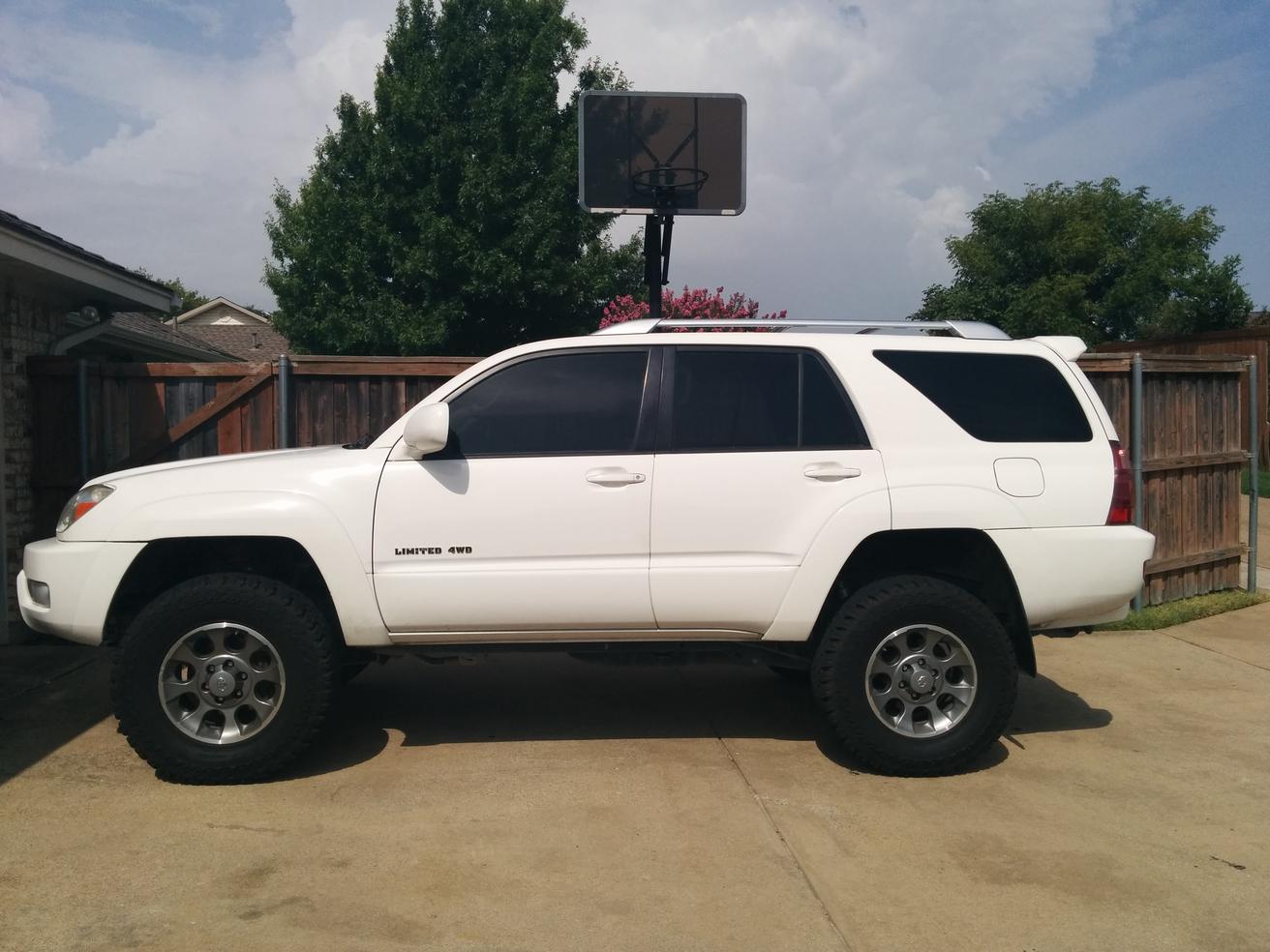

D dawg, do you have your front coils raised all the way to 3inches? Or about 2? Not sure if you had problems after installing the 285s st Max
I'm not d Dawg of course but I have the toytec boss with superflex HD 2.5" HD rear coils in my v8 04, with the same tires. I originally had spacers that rubbed like a mofo all the time and it drove me crazy. Took em out and no problems. My coilovers are at the height set from the box with no problem. Haven't even had to clearance the body mount, just had to cut the crap out of the fenderflares and push the liner forward.
TE+6; my coils are set at the 3 inches. The only issue I had was trying to get the 285s aligned within accepted alignment spec after the lift; took a couple of tries but all is good now. I have no issues at all with the setup!
