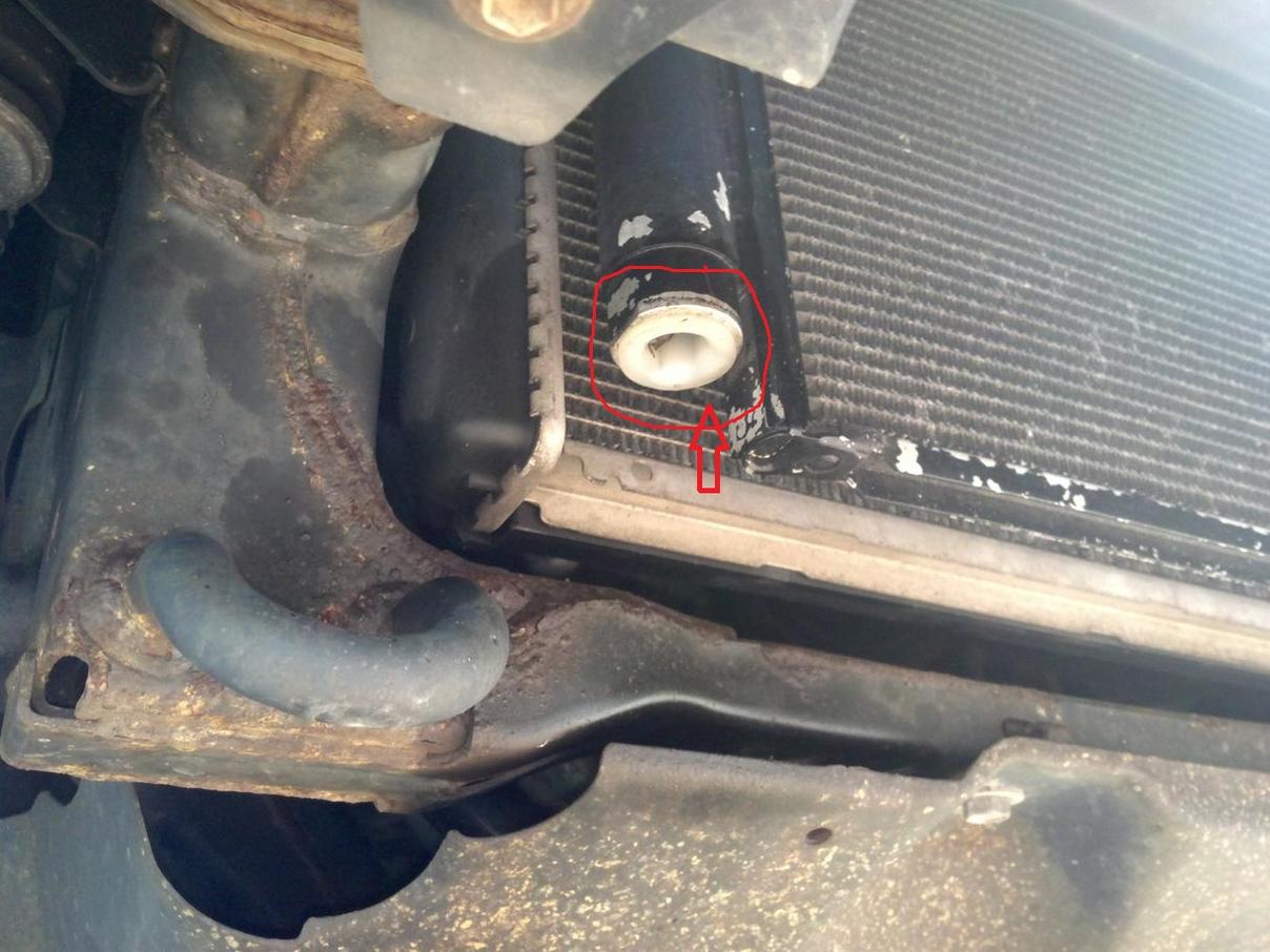

[MENTION=11004]4RBob[/MENTION] , can you please show us a pic of the drier/plug, if possible...is it easily accesible?
This is not mine, searched for it as I remember seeing it before when I was searching on A/C issues. Mine was actually much more wet. The drier is on the side of (part of) condenser (radiator type thing behind the front grill).
AM ASSUMING ITS THE PART I CIRCLED IN RED?.....u mentioned wet, so if its leaking from there, that area would be a lil wet?..or u can feel freon escaping if u put ur hand there.......or it must be via uv light etc?
Yes, that's the part. It was very wet on mine. It was also a little damp at the bottom connection on the other side of the condenser. The condenser had a ton of little pebbles in it and was a bit dinged up.
I should back up a little bit. We had tried adding some freon (using gauges) before, but it only helped for less than a week. I saw a $10 coupon for Firestone to do an A/C check. I already knew about the wet drier before this. Firestone called and said they couldn't find anything and said it was blowing "pretty good" at 50F. I highly doubt it was even that cool. I mentioned the drier to them and they said "oh yeah, we can try changing that". They were going to change it themselves, but called me to tell me they were worried about damaging the drier/condenser when taking out that plug (I mentioned before was impossible because of corrosion). I told them I would change it or the whole condenser myself and they can do the evac/vac/recharge. As I mentioned before, ended up replacing the whole condenser.
Before the repairs/recharge were done, I noticed the compressor was cycling on and off like crazy (1-2 seconds on, 1-2 seconds off several times then 30 seconds on once in a while). I also did the sight glass test (you can search for a pdf on this on the forum). There was nothing going on in the sight glass at all. AFTER the work was done, when you turn OFF the A/C, you see some bubbles/foaming then it clears up. This is correct according to that test. The compressor doesn't cycle like crazy any more either.
I should say this is appearing to work for us right now, but it hasn't been that long so I can't say for sure if it is THE fix. I figured it was wet and it was worth trying as it is one of the cheapest/easiest components of the AC system and it is kind of a wear and tear item getting beat up in the front there.
