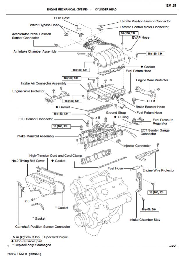

Anyone know of a diagram of the entire engine bay? I just want to know exactly what everything is when I pop the hood. And by everything, I mean everything - every vacuum line, wire, hose, pipe, etc.
Does anything like that even exist? Exploded diagram maybe?

Workshop manual maybe? Is there anywhere to download the workshop manual that still works? Toyota must have taken them all down.
there should be a vaccum hose diagram under the hood already. Other than that, a diagram like you are asking for doesn't exist.

Are you talking about the Service Manual Repair Book? Like the one below image?
