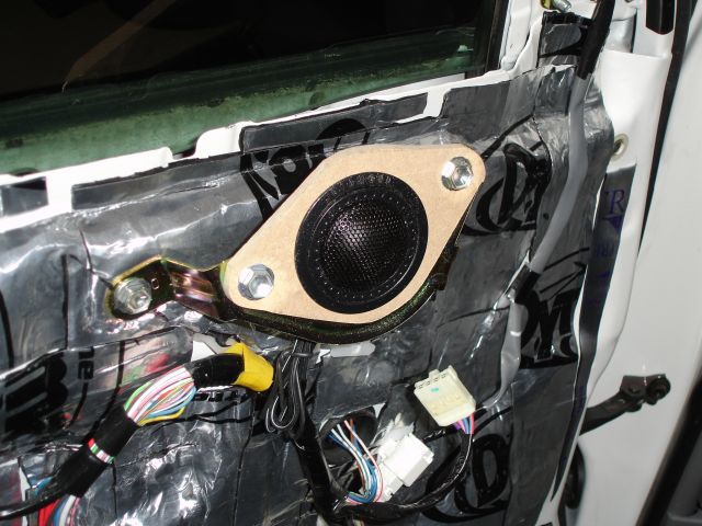

i have diamond comp. on my 05 runner and a friend has infinity kappa comp. in his pathfinder we installed them 2 yrs ago together, my still sound great his, da right side blew and we both listen to da same music and niether blast it. also to install them u need to make a bkrt of some sought for da tweeters i made it out of mdf wood

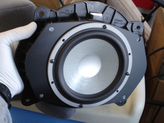

You can fit 6 1/2 in the front and rear, just slight modification to the stock speaker bracket. Also, the tweeter mount for the front is very easy to make. Just remove the stock tweeter and trace the outline of it on to a piece of 1/4" MDF then cut it out with a jigsaw. BTW, Crutchfield has pretty high prices and they are very conservative when it comes to what fits and does not fit.
I'm running JL Audio XR Coax in the rear. Here are a couple pictures of the Diamonds Installed up front. I made my own tweeter mount and mounted it to the stock bracket.
For the speaker I used a 6x9 to 6 1/2 mounting plate.

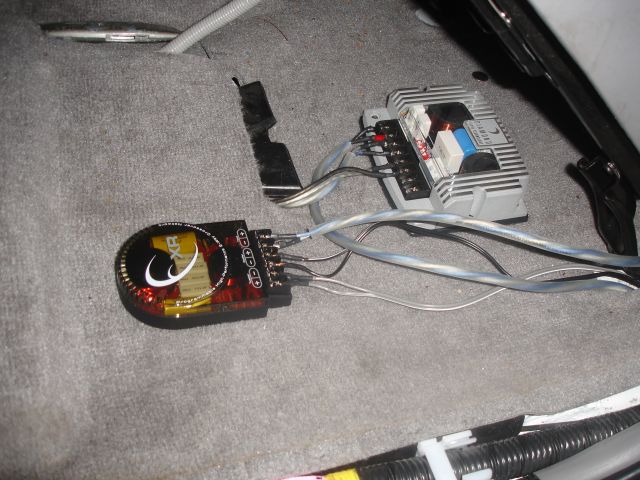

I don't like to install my crossovers inside the door due to the possibility of moisture getting into them. I placed my front and rear crossovers under the drivers and passenger seat. It's much easier to loosen a few bolts to the front seat to adjust the crossovers if needed (taking the door apart can be a pain!). Both the JL Audio and Diamond Audio crossovers are programmable. Here is a picture of them installed:
