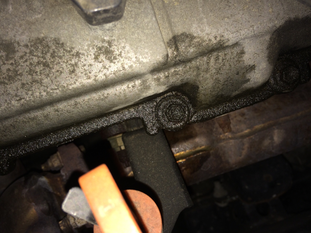

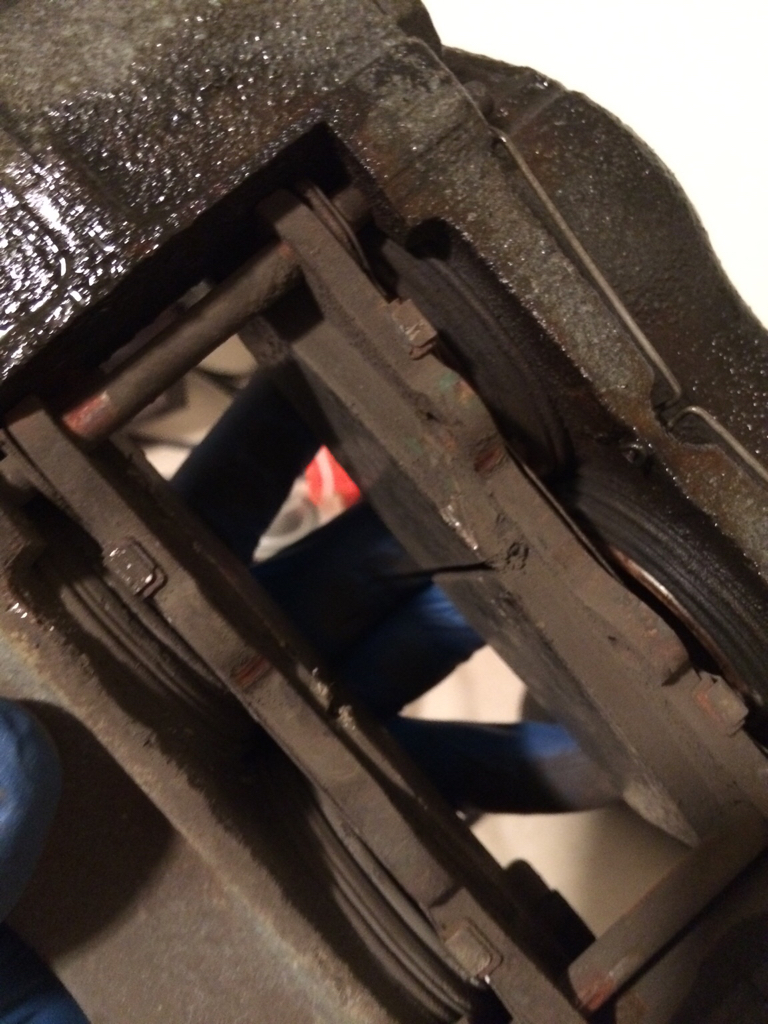

I won't reply to everyone but will try to cover everything.
Yes, I meant valve cover gaskets.
Previous owner just had generic service records such as fluid changes, alignments, details,
The warranty will cover any wear item except for brakes and physical damage. It is through a third party company, not the dealer-but advertised and handled through the dealer. Their rep denied the repair to radiator because he claimed the damage was from a rock. I paid the dealer for a timing belt change and they said said the water pump was shot- they reported it to the company and since that was discovered during another repair, (it was the initial failure) it didn't qualify.
And yes, I know about all the common problem. Oem thin front brakes, pink milkshake, leaky valve cover gaskets, Lower ball joints, rusty undercarriage etc.
I have Toyota lower BJs to go on, B&M trans cooler and Toyota filter

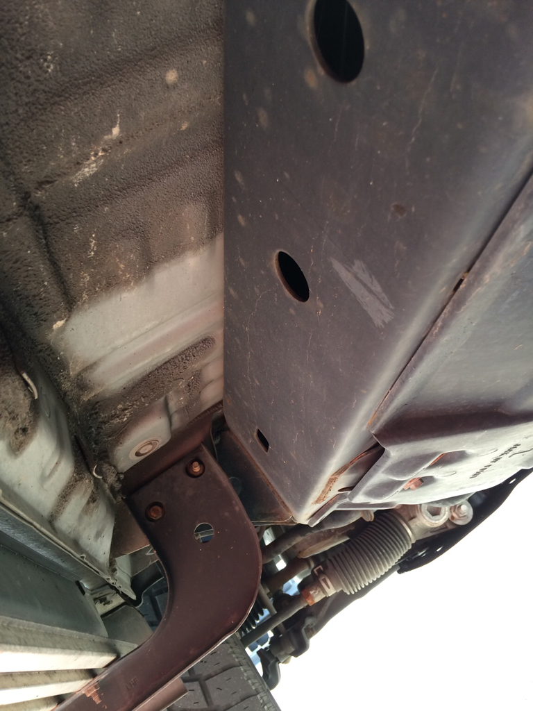

Undercarriage is spotless and I just undercoated it. I checked for evidence of valve cover leak at the dealer thinking they may have just pressure washed it. There was no heat staining on the cylinder heads or exhaust manifolds. I test drove it for over 70 miles hoping over that distance, any potential CEL they cleared would show itself- didn't until I purchased it ironically.
I tried varies stop distances with my hands off the wheel and zero noise, pulsing, or pulling of the wheel. Two weeks later a caliper locked up.

Look very clean ^^ worth the effort / zero rust to deal with, is a huge plus.

2) Rust and structural integrity should be checked, on a hoist.
- some Southern dealers buy cheap Northern vehicles, to flip

it already looks pretty good rust wise

I had the same exact issue with my brake caliper right after I bought it. Also covered under the warranty right? What does "thin" OEM pads mean?

Again I'll try to answer most questions. Mainly I felt like venting because I haven't made it 1 oil change interval in and almost every 3rd problem has shown itself.
Coolant was good- a little dirty but no signs of pink milkshake. Original radiator too. Oil was full, and clean, trans fluid was at proper level, a little darker than I would like but have everything to perform a full flush and cooler install.
It was a 1 owner car that was a corporate and then the owner purchased and traded it in at the Lexus/Toyota dealer for a new vehicle. Seemed a little more legitimate than any ole used car lot. The body and undercarriage was spotless- zero signs of leakage or seepage
The only reason I caught the radiator leak was because I bought and installed a scan gauge a week after purchase. The truck was running about 212 and I had them pressure test it. The leak was so small it was pressurizing the coolant into a vapor or mist-there was no wet spots or evidence of leakage until a pressure test was conducted will parked.
And poor oem brakes was referring to the thin front rotors. And yes I replaced the entire front setup while also doing the TBU at the same time.

I have the check engine/vsc off/vsc track lights on. It had a new gas cap so PO already tried that. I replaced the maf and air filter with no luck. I am sure it is a vacuum leak due to the idling issues. Just need to smoke test it to find the source. The intake gaskets are not the source because I do not hear any "sucking" sounds from under the hood.
It's goes back the 27th to check on replacing the leaky valve cover gaskets. I talked the the sales manager who I personally dealt with about getting this repair covered
