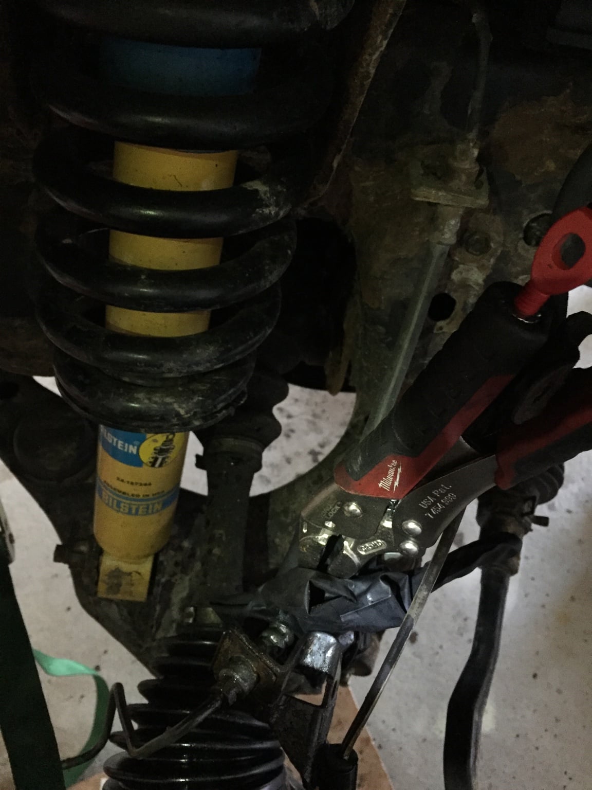

1 - Unhooked the brake line from the caliper. I used needle nose vise grips on the flexible brake line to stop it from leaking fluid and removing the mounting clamp

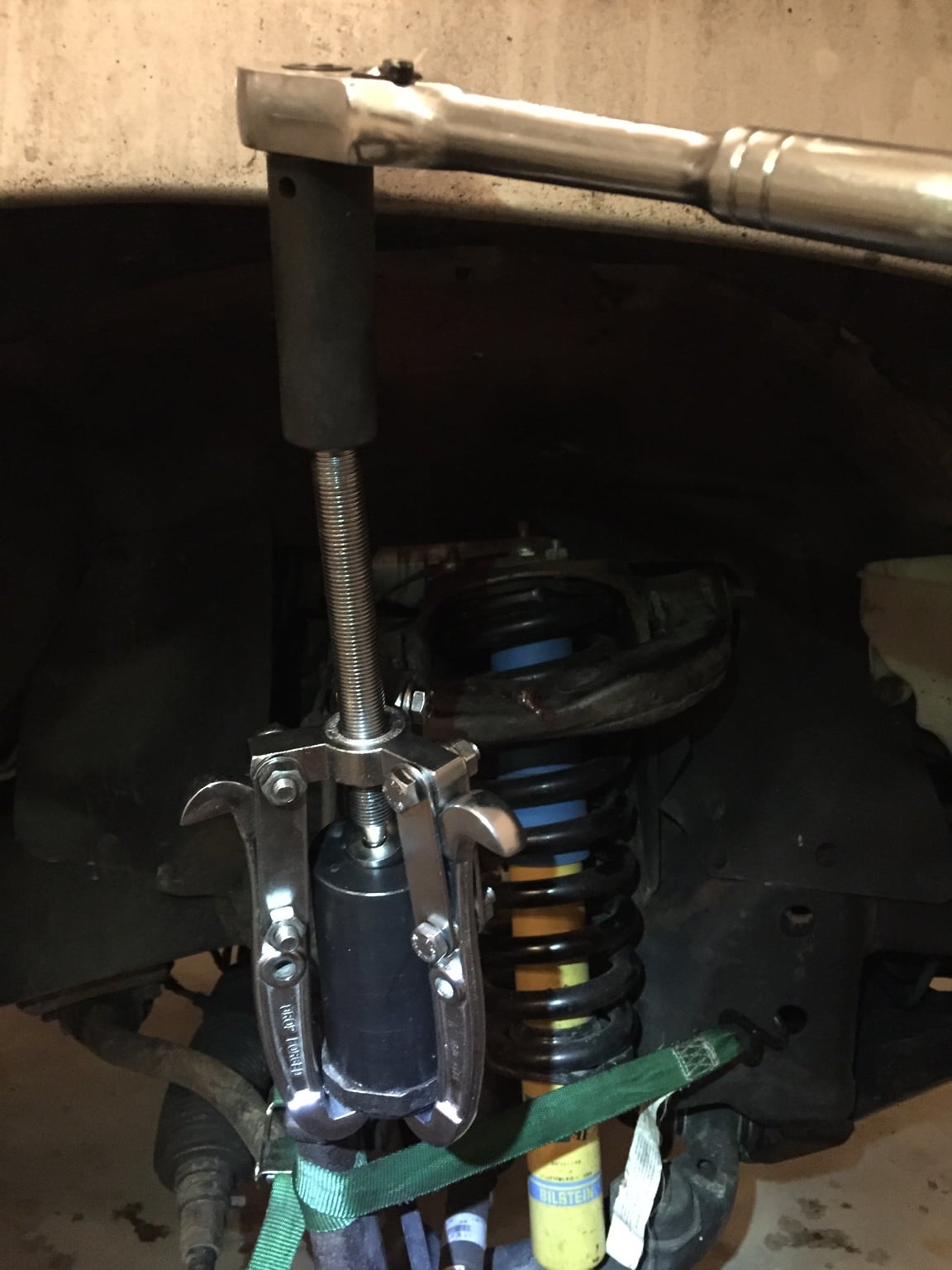

3 - Let the spindle hang down, although I did use a ratchet strap wrapped around the spindle to help keep it in place. Maybe this is bad for the CV since it’s holding the tension, not sure.
Using the impact outside the wheel well was essential. I couldn’t get anywhere near enough force on it just by using a wrench inside the wheel well, and couldn’t fit a breaker.

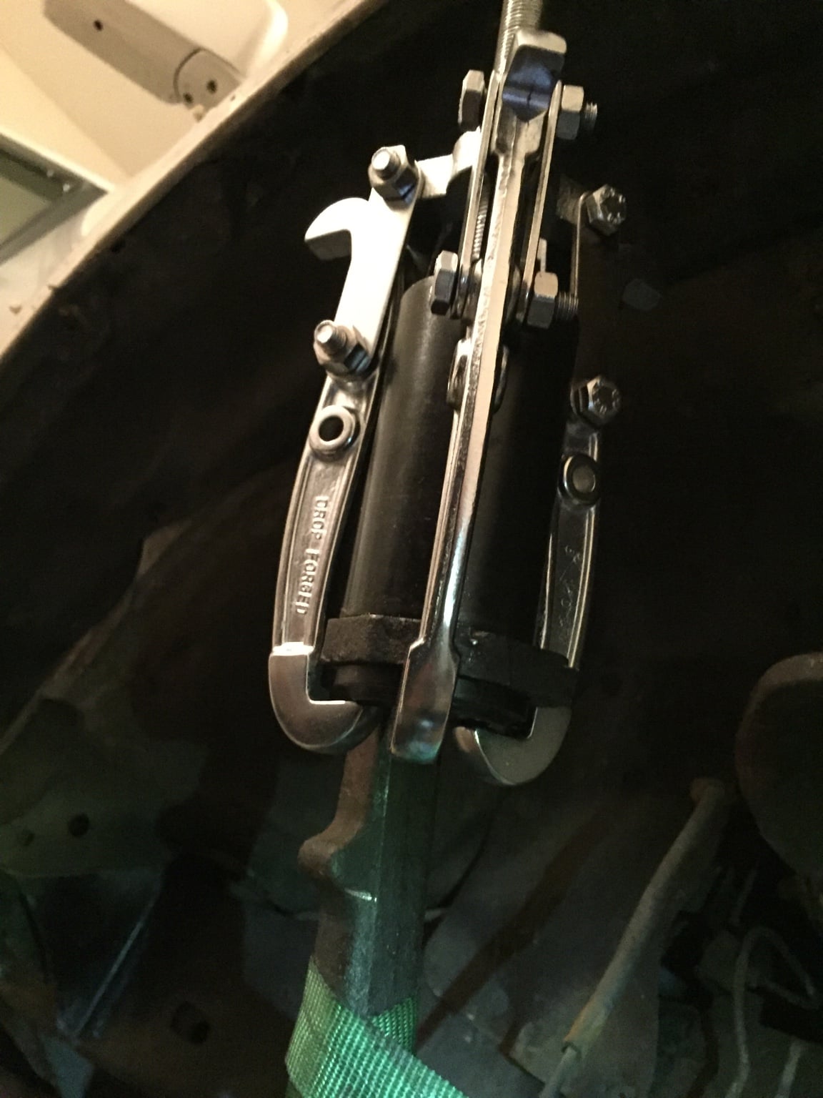

I used two different methods to press the new UBJ in. The press had the correctly sized adapters to do the job. I also used a harbor freight 3 jaw puller (got a set of 4 for $27), which I like way better than the ones you would rent. Either tool worked fine.
I didn’t use a flat piece of steel or anything to press the UBJ in. It started off crooked, but straightened itself out, I ratcheted it in slowly to make sure I didn’t screw it up. Also put the UBJ in the freezer.

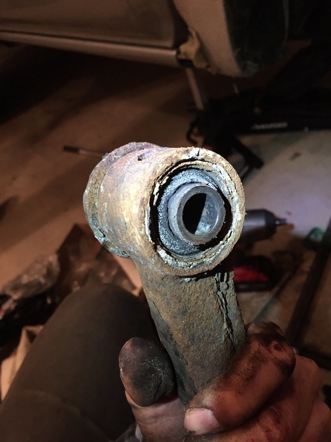

For the UCA bushings - the press was super helpful, but the adapters weren’t small enough to fit the rubber bushing so I used a socket that just barely fit inside. Here’s what my bushings looked like:
I would use the press to put some force on the UCA bushing until it compressed and didn’t want to easily move. Then I’d hit the outside of the UCA with the torch for a minute or two which would help it release from the metal shell of the UCA.
I tried to minimize smoke so I didn’t just straight burn them out. There was still some rubber and rust stuck to the inside walls, so I hit that with my harbor freight electric die grinder and carbide bit to clean it up.
I used ES bushings so I had to also press the metal shell in further. That was really hard to do (my impact driver deformed the outside of the shell) until I read a write up that said to use a torch on the outside of the shell first. That helped a ton.
As you can see in the pic above there was a ton of rust on the LCA. I also took the time wire wheel off as much rust as I could, spray on a rust converter, and hit it with some rustoleum. Also did fluid film a few days ago.
