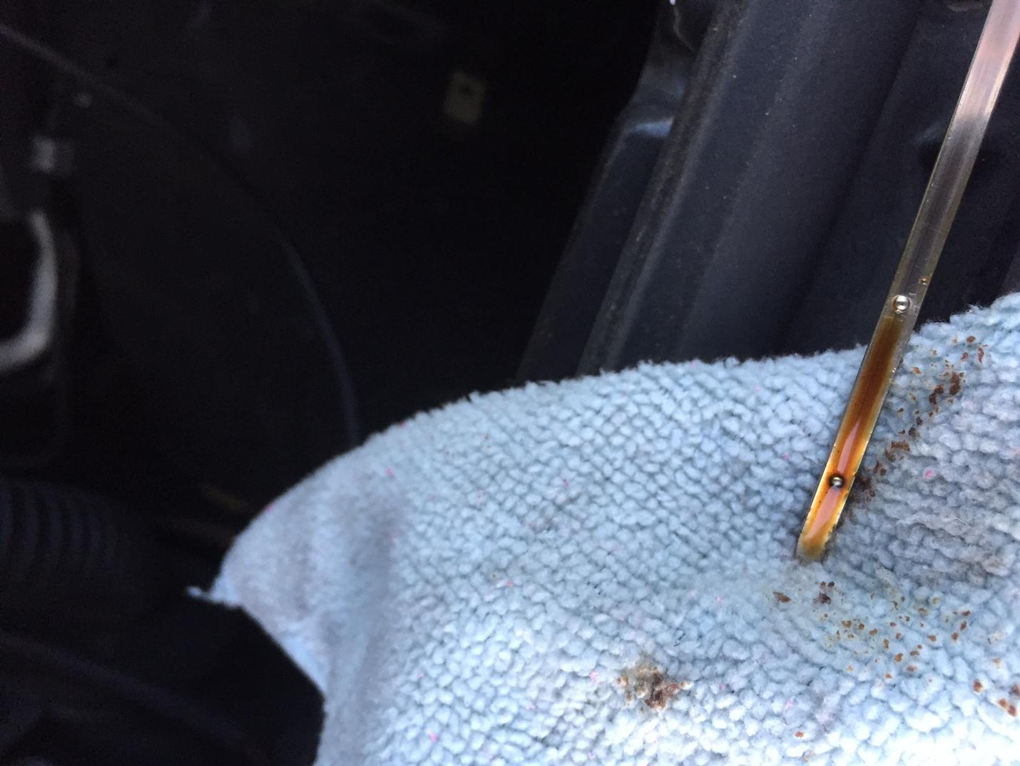

I went for an oil change at my local Toyota dealership, I had a 20% coup.
After waiting a while, the tech servicing my 4r called me over to go over a long list of services I need, including:
- replace PCV
- replace main engine seal as oil is leaking in the rear
I told him just to do the oil change and that I would change the PCV my self.
I asked when it would be done since I doubt they even started the oil change without knowing if I wanted them to replace the main seal or not.... It has already been over 1 hr. at this point.
Service tech said it wouldn't be much longer. ~ 30 mins later my vehicle is ready.
Paid the $70 (pennzoil full synthetic oil change w/ 20% off) but driving off I notice they didn't give me a new service reminder sticker, I went back to get one. Couple of days later I notice my maint light wasn't reset either.
Fast forward two weeks to today... I was replacing the PCV and decided to check oil. Is it me or does it look dirty for having been changed less than 300mi ago?? It had been just over 5,000 mi since my last. Do you think the dealership really changed my oil?
Is there any way to know for sure?

Hard to tell without knowing your vehicle. It looks a little better than my V8 oil at 5K but not after an oil change. Is the filter new? And $70? If you offer me a good IPA or two I'll do it for the cost of mobile 1 from walmart and an OEM filter.
Looks like pretty new oil to me. You could send a sample to an oil analysis company like Blackstone Labs and they will be able to tell you with pretty good certainty if the oil has 300 miles on it or 5300. Downside is that you'll have to take the sample while draining the oil which means you'll need to change the oil again.
But to be honest, that oil looks new to me.

the reason I do my oil changes IS they do not drain all the oil out. so now they add new oil and then the new oil does get discolored quickly.
my suggestion is drop the covers and inspect that the oil filter and plug was messed with . if its dirty then they did not drain it or perhaps just changed the oil but did not do the filter.. etc...
I am guessing they did drain the oil, but not thoroughly. Provably pulled plug to get bulk of it out and replaced right away. I use eitger Amsoil or M1 and let it drain almost an hour. My oil is hard to even see on the dipstick for the first few hundred miles. That oil on yours looks like kine after 5k miles. Do yourself a favor and start changing your own.
I also drain for 45min engine hot. until it does a drip every 30 sec..
I have a 175K V8 GM vehicle 10K oil changes same deal. oil is very light brown so much so I have to tilt the stick to see if its at the full mark.
time is money so I agree they did not fully drain it so it looks bad.
Now that you say it, it sounds like the most likely scenario.
