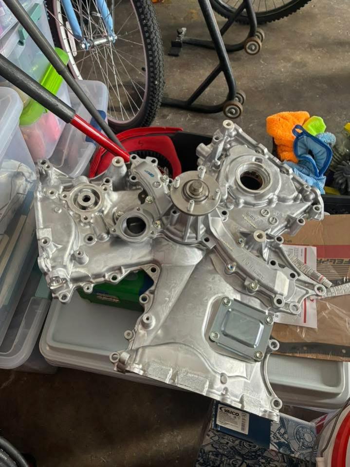

i did open it back up, was clean as whistle. i definitely change my oil regularly. i already ordered the aisian timing cover, comes with the oil and water pumps installed.
this bad boy came in fairly quickly. oil pump and water pump included.
