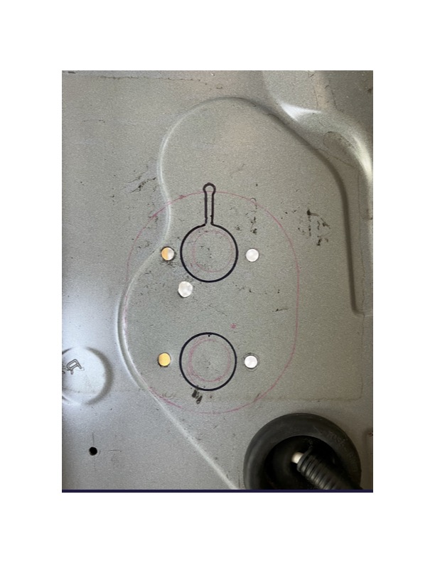

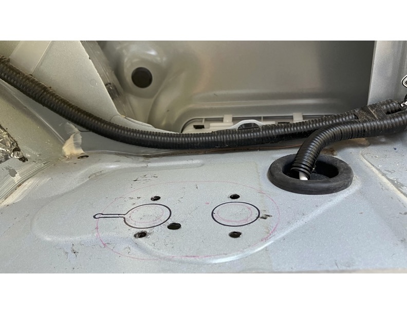

I picked a location to install the 12V diesel heater: on the 4Runner sheet metal floor, in the rear passenger side corner, between the wheel well and the rear hatch.
Photos show the top view; the side view; and the view from under the vehicle. In the photo from under the vehicle, the 3 long bolts hold the heater mounting plate to the floor.

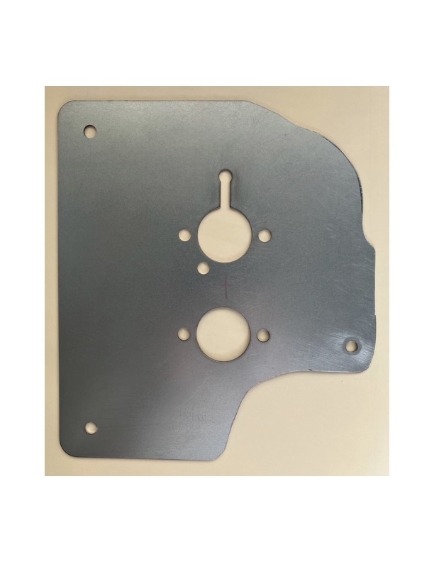

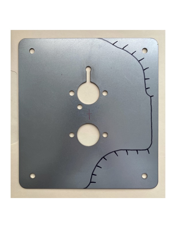

I had to trim the mounting plate that comes with the heater to fit the space available. Before and after shown.
Originally, I was going to drill separate holes in the floor for the combustion exhaust pipe, the combustion air intake pipe, the fuel line, the four bolts that attach the heater to its mounting plate, and the four bolts that attach the mounting plate to the 4Runner floor. But after trimming the mounting plate to size, I ended up drilling just three holes to attach the mounting plate to the floor, and then I cut two large holes for everything else. (The small, 1-gallon diesel tank will be inside the vehicle, so I still need to drill a hole nearby so the fuel line can be routed from the diesel tank to the underside of the heater unit, where it enters the combustion chamber).
The combustion exhaust pipe will come straight down from the heater unit, then bend almost 90 degrees rearward, ending about where the 4Runner exhaust pipe ends, but outboard of that pipe.

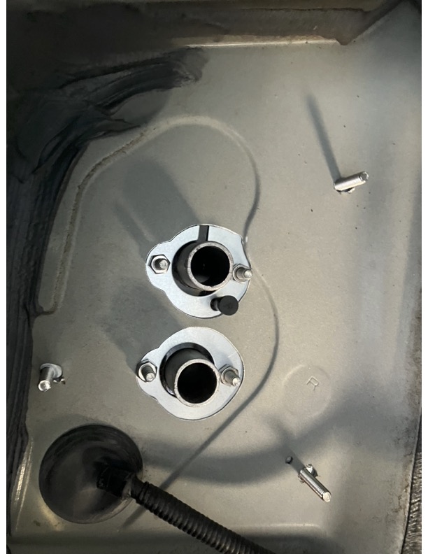

Spacer Under the Heater Unit
One of the photos shows a large rubber grommet and wire loom going through the floor, pretty close to the hot combustion exhaust pipe. The grommet almost touches the outside case of the heater unit; I can just slip an index card in between. I wanted more space so that I could insert a piece of heat shield material in between, to protect the grommet and wire loom from the hot end of the heater unit. But I didn't want to move the Toyota OEM wiring, so I ordered four more mounting plates (from a different manufacturer) and trimmed them to size. Stacking these four extra mounting plates on top of the original one will raise the heater unit by maybe 1/4", allowing me to slip a piece of heat shield in the gap.
I will install with Permatex Ultra Black Gasket Maker Oil Resistant 75190 below each of these five plates.
