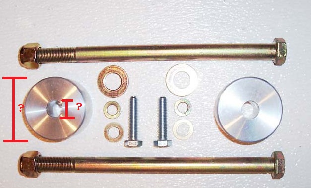

Diff drop - How can I do it (DIY)?
Thanks sn0wrunner! But I need the dimensions to construct this!
Look this picture that can explain that I need:
Sorry those dimensions I don't have for you off the top of my head. However, they really aren't important. The overall diameter of the spacer doesn't really matter. If it's 1", 1.5", whatever, it really won't make a difference. And the inner diameter just needs to be big enough to fit your bolt through. I'd suggest buying your 8" bolts and constructing the spacers around the bolts you use.
Should be pretty easy. Good luck!
Easiest thing to do would be crawl under it. You just want to make sure the spacers are at LEAST the same width if not a little wider than the stock ones. As far as bolts, I'm pretty sure they're 1/2" but don't quote me on that.
