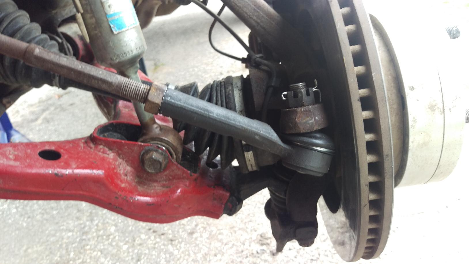

I'd like to point out that it depends on what lift you have on how they effect cv angles. When I had my bilsteins on 2.5 my angles were fine. With them on 0" lift but a 3" spacer above it they are maxed out to the point of binding and are about 1/8th of an inch from the lower shock mount as pictured below. I originally tried setting my Bilsteins at .85" with the 3" spacer, no bueno. CV's wouldn't spin and the cv boot hit my lca shock mount.
Hey t-man, is that pic of your current setup or the the Bilsteins at .85? No offense but those angles are ugly!

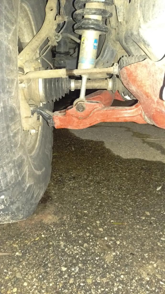

I should explain further, my bad, the pic is at full droop on that picture too. So with the tires on the ground it's not so bad. But, if you go offroad, I do quite regularly, then you will be drooping that front. Normal driving, you'd be fine. I'll try to get another pic.
Ok, hard to tell on picture but at ride height it is just below level. So no issues there. Like I said, the problem arises if you flex your suspension out like I do. uploadfromtaptalk1449100355981.jpg
