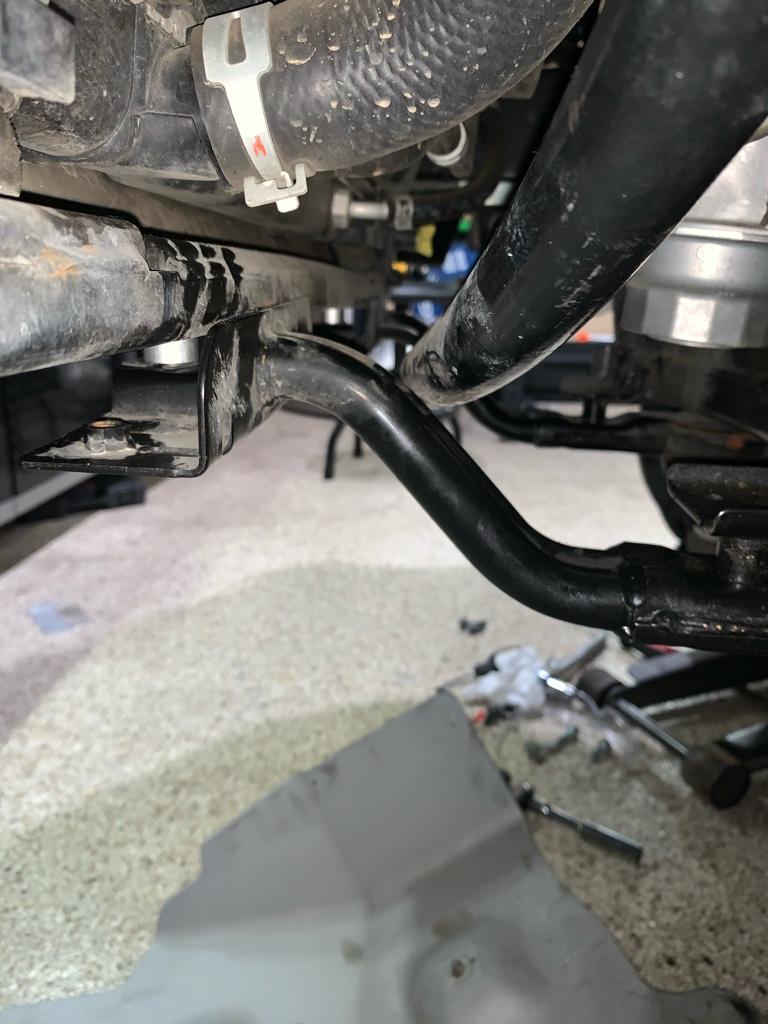

Reviving an older thread here. There are a few threads on diff drops and it gets brought up regularly in lift threads. If I’m reading all this correctly, it provides little if any improvement for the CV angle but many choose to do it because they feel it doesn’t cause any harm other than some skid plate fitment annoyance. Though there are some out there concerned that “clocking” the diff may potentially affect lubrication within the diff…
If the CV angles aren’t really being affected much then not installing a diff drop shouldn’t help or hurt the drivers side needle bearings and accelerate the need to install the bushing? (I’m doing a 2” front lift so mine is minor and honestly, my diff appears lower than the wheel bearing so my CV shafts go up as the go out, so raising it may just change the angle from a negative to a positive…if that makes sense.)
