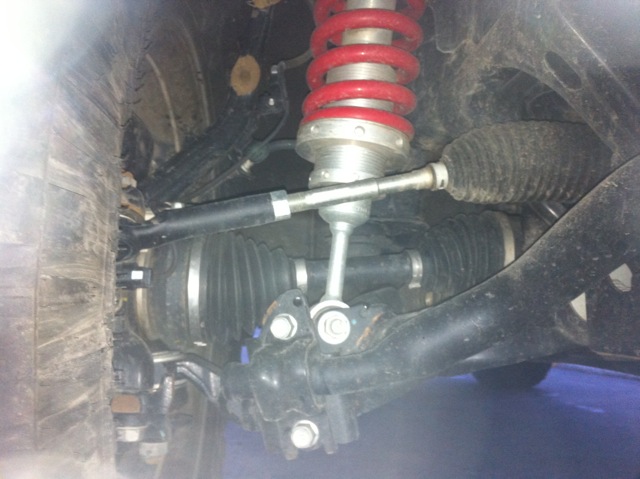

Here is what my CV's look like with the wheels straight just sitting in my garage before diff drop
Idk if I'm missing anything in the picture... but it looks like it should be fine.

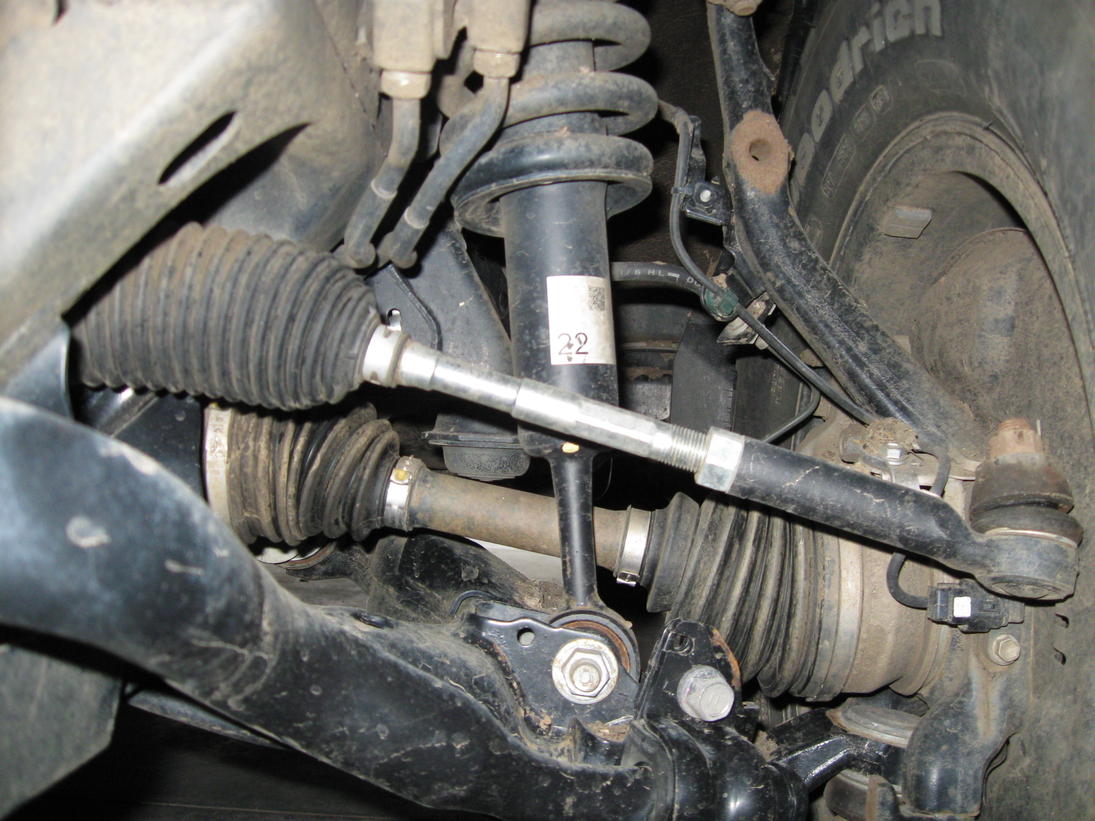

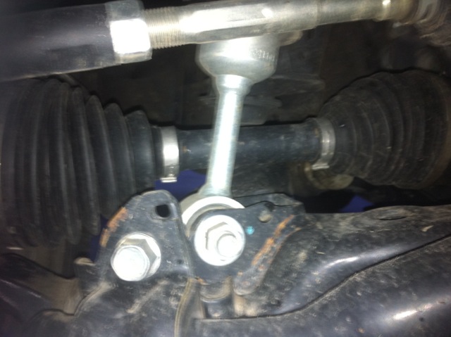

You got me wanting to look at mine... so i snapped a couple pics with the phone in the event that might help you out.
Either way its beyond easy to take the diff drop right back off if there are any contact issues.
