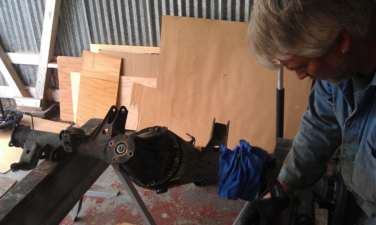

So in the process of doing my e-locker retro fit..
And the wife said I could go with the OME lift
What I'm trying to figure out is do I need new link bars to keep the axle from moving forward in the rear...and how important is a new panbar too to keep the axle even.
I was looking at the 883 to get my 3" of lift in the front and 890s for the rear.
Also assembled or not? I got a press and pretty mechanically sound just wondering if its worth the 100 they want...any advice is much appreciated. I'll start a build thread as soon as I can get more then a few minutes..hehe
Thanks in advance.
That's my dad in the picture I got him hard at work =D

I dont exactly understand what your asking. You have a 4runner and your just swapping rear ends right? Why would you need new links if you all ready have some? The panhard is really important, but then again why not just re-use the parts you have.

BTW, I notice on your pic that you havn't done the rear diff breather extension mod. You should do it even if you won't be doing river crossings to prevent corrosion of the breather, and thus pressure buildup that could cause axle seal leaks. It super cheap and easy.
