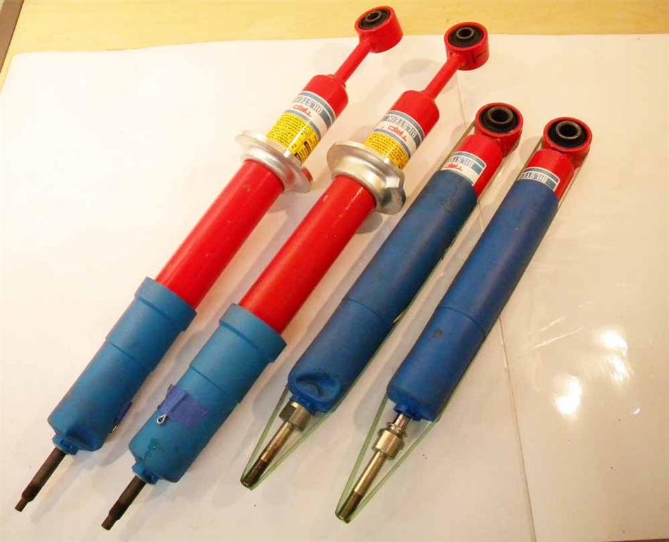

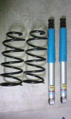

These are the shocks I'm getting. The rear shocks of an fj trail team has these black bushings or something on the end that goes to the frame. I couldn't find a good pic of a fj trail teams shocks but I agree the 2010 fj shocks are the ones to avoid. they might work on a 5th gen 4runner but I'm not sure

Thanks for posting that picture up, SkylineGTRacer. I see that the TRD shocks don't have that black bushing on the end of the shock (just like all the other after market shocks), but the older FJ Bilstein shocks have the same black bushing that the 2010 ones have.
Thanks for posting a picture to compare. Do you know if the black bushing on the TT shocks is removable?
A bushing is a bushing. The color means nothing. It could be rubber or poly.
Either way it can be pressed out and replaced.
