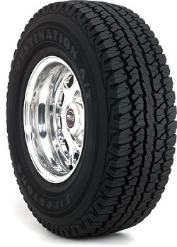

The Firestone Destination A/T
I think this problaby fits your needs

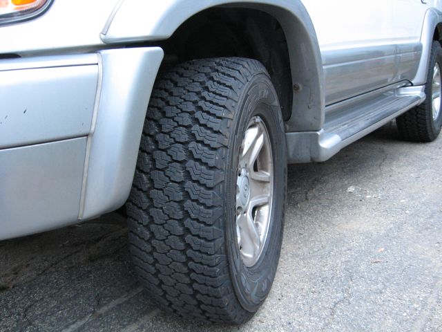

I replaced my 'flops with GY Wrangler Silent Armor's. Very pleased with performance and wear. Not cheap.
I posted photos on page 12 of the RL Goodyear Wrangler thread
Here is one of them.
attachment.php
EDIT - One of the primary reasons for my tire selection was for snow and ice. Seeing how you are not in the snow belt, these may not be the tire you are looking for,
