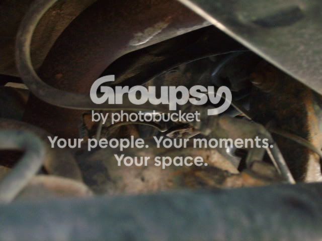

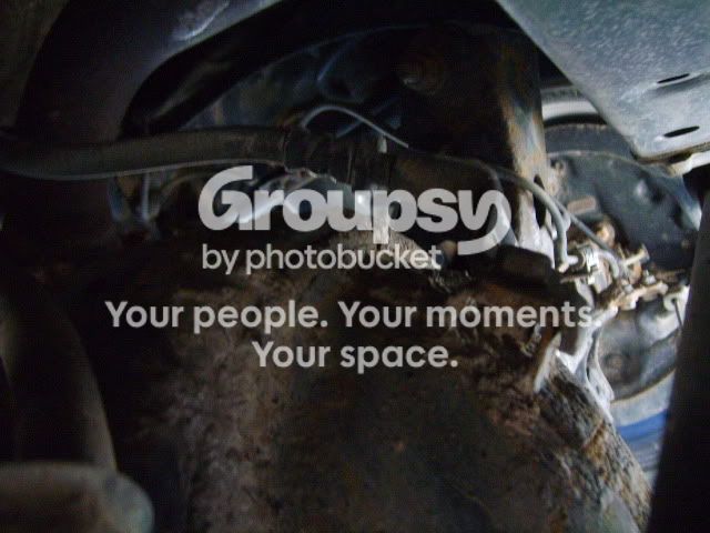

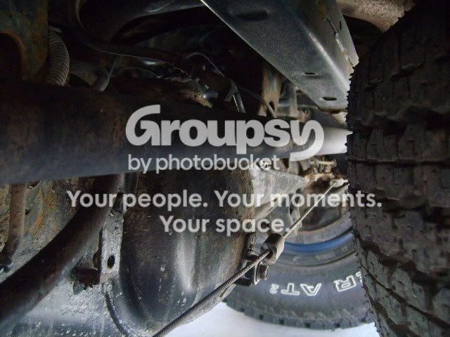

I crawled under my truck this morning because i too am planning on doing the rear differential breather extention mod however when i got under there this is what i saw. do i already have one? is that hose on the top the extention?? thanks
mypics012.jpg~original
mypics013.jpg~original
mypics014.jpg~original
ahhhh i hate rust!!
