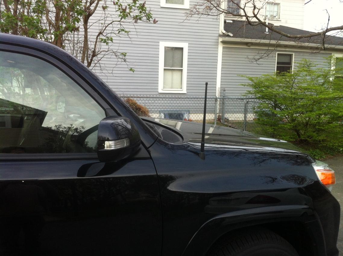

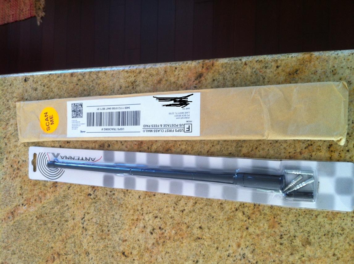

Hi Qjake - just added some installation notes you might find helpful. good luck.
Thank you! I too was wondering about that plug for the engine compartment intake, there is no mention of it in the destructions other than it being on the parts list. :shrug: Also good call on fenderwall seal i'll be sure it's sealed tight.

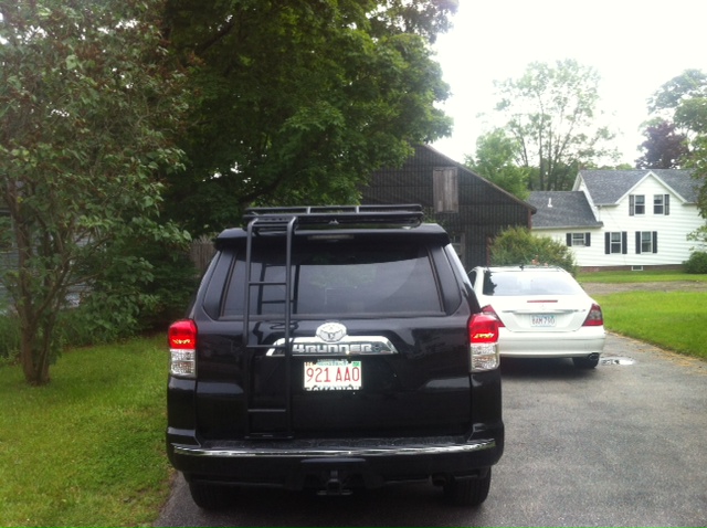

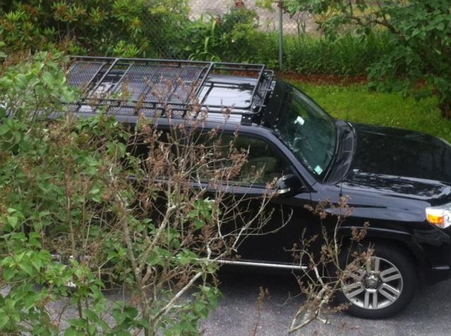

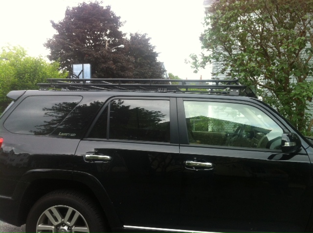

Gobi Stealth Rack Installed!
Some pics of the Gobi Stealth Rack installed. Purchased from RiDE on this forum.
Love it.

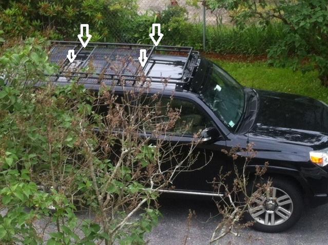

Gobi Stealth Rack - observation
Wanted to point out a quick observation on the Gobi rack. I'm just realizing that the two cross bars that go across the middle of the rack are higher up, breaking up the cargo space areas.
This isn't a bad thing and probably makes sense for most applications since you can segment your gear and the bars can act as a latch for the bungee/tie downs while also preventing gear from sliding around.
What this does mean though is that something longer than the sections will ride on top of the rack vs inside it. Something like plywood or a bureau would not sit within the cage, it would be on top of it.
Anyway, like I said this isn't good or bad in my opinion just hadn't thought to look at that specifically before purchasing. Would I purchase again knowing this, for sure.

knowing what you know now...
So knowing this about the top cross bars, and knowing that Gobi will customize it for you, would you suggest just 1 cross bar? centered on the rack? making 2 equal areas to store gear? or would you leave it as is?
I ask because I was thinking about asking to have mesh along the entire bottom (no break in the mesh), ask for 1 cross bar and order the sunroof insert. But I also have the J shaped Yakima universal kayak racks that I put on when taking the yaks to the lake. So I would need 2 cross bars unless I could use the rear of the rack and 1 center cross bar.
Any thoughts?

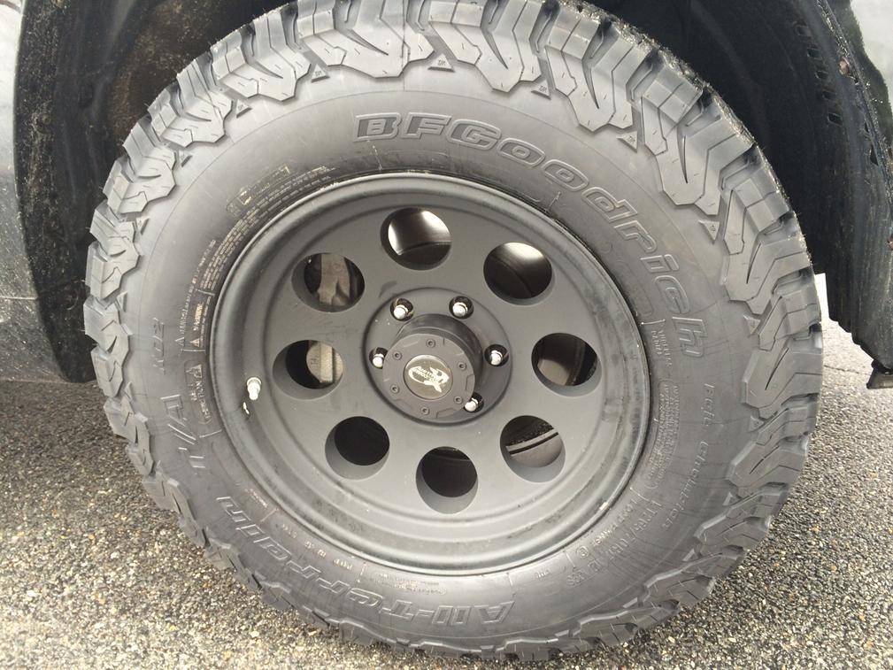

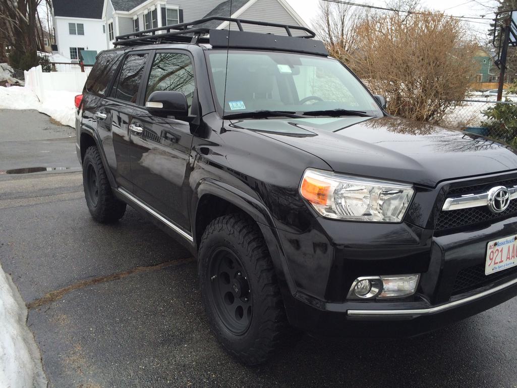

So I've been pretty inactive on the forum and haven't been doing any work on the Runner for the past year or so. Life, work, pregnant wife, you name it. I've been waiting for the factory tires to finally wear down so I could finally put some new shoes on. That day has finally come!
There have been a few recent posts about the KO2's and going from a 20" to 17" wheel so I thought I'd post some pics and provide some feedback.
I went from the stock 20" Limited wheels with factory 245's to a set of 17" Procomp 7069's with BFG TA/KO2 265/70/17.
I just picked up the truck a couple hours ago and have only driven about 20 miles. The two things I tried paying attention to right off were road noise and "feel" of going from 20 to 17.
Road Noise - Nothing on secondary roads and nothing on the highway until I hit over 80mph. I was expecting more noise going to the AT tire but was pleasantly surprised. I don't usually drive over 75 so the fact that the noise picked up at 80 isn't a concern. Side note: the guy at the tire shop said that road noise from AT tires isn't usually from the tread but rather a symptom of not rotating the tires frequently enough and the tread breaking down. He said because of the tread they should be rotated every 3k.
Feel - this is hard to explain but you can notice a difference but I think really only because I was paying so close attention. The only thing I really noticed was when I turned a little harder that normal there is a little more give side to side. This was to be expected having more rubber on the side. I actually like the way the truck rides now.
I was seeing 17.1MPG prior to the swap out and will report back in a little while to say whether that changes either way.
Overall - really happy with the new look and feel. With the black rims I'm noticing the chrome trim everywhere...time to get the plastidip bottle...
