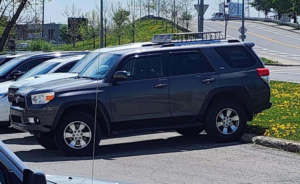

My wife and I picked up a 2012 SR5 in magnetic grey 2 years ago. We agreed she wouldn't spend money on it until it was paid off. I don't have that same constraint, so I started working on it right away. :D
Here's what it looked like the day we got it.

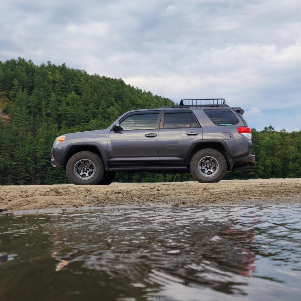

The first thing we did was to get new wheels and tires. We looked at the popular names in the wheel market and the model my wife settled on was the Fuel Shock in Anthracite/Grey. 17x9 ET1. We were also looking at tires and while we considered the popular options many people put on (Wildpeaks, KO2) we ended up going with Fuel Gripper A/T's since Fuel was having a huge sale and the product looked good. (looking back on it now, we're super happy we went with this option as it's been nothing but great for us). We went with the 33" variant over stock size. (we also tinted the vehicle - 5% over the factory rear tints and 35% up front)

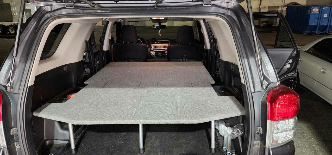

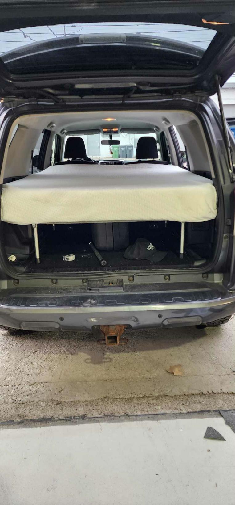

Late in 2024, once work slowed a little at our shop, my wife wanted to go try camping. I was busy over the weekend and couldn't go, but I made time to build her a platform so she could drop in a memory foam mattress. This is the sleeping set-up w would end up using all throughout the 2025 season as well.

Working on the vehicle is fun, but we took most of the summer to enjoy the outdoors whenever we could. Next post will be a "what did we do to it" update, but for now, some pics of some camping and trails.
Rig looks great and it appears you are enjoying it. Quick question on the tires, you don't mention any sort of lift or other mods so wondering if you have had any clearance/rubbing issues with the 33's?
We in fact do not have a lift yet. Only leveling kit on the front. (we're doing our lift this year) We did have some mild rubbing on the passenger side due to the factory SR5/OffRoad skid plate which we trimmed back. There was also some rubbing on the front fender liner which we trimmed back. There would have been more issues if we opted for a more aggressive offset wheel, but with these it's minimal.
