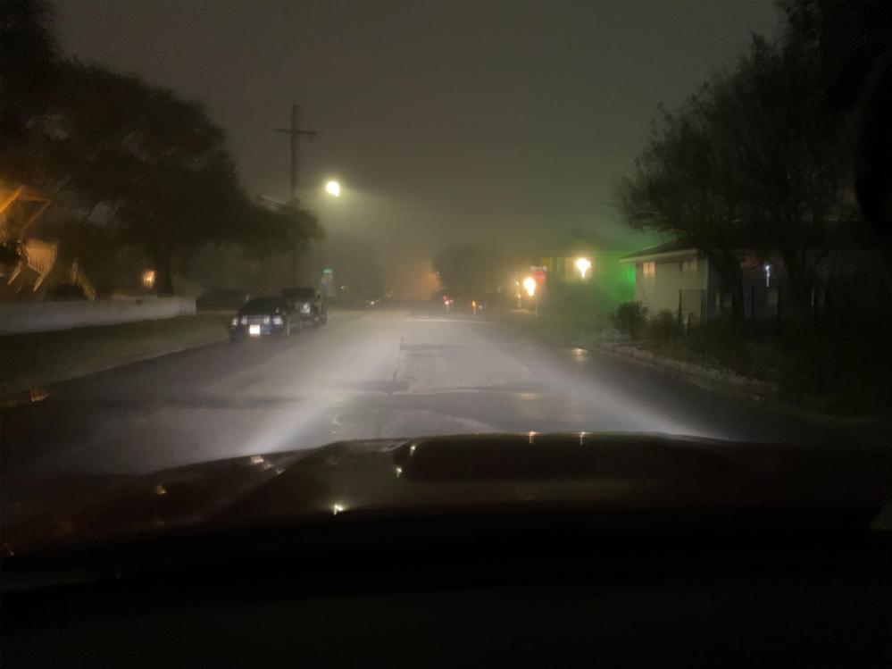

I mostly wanted to talk about beam pattern though. We have had some very foggy conditions lately, so it gave me a great opportunity to go out at night and actually be able to see the beams in the air rather than just reflected against a wall. I took all these photos with a new iphone with the night shot mode mostly on, so don’t look at these as a relative brightness review.
5943

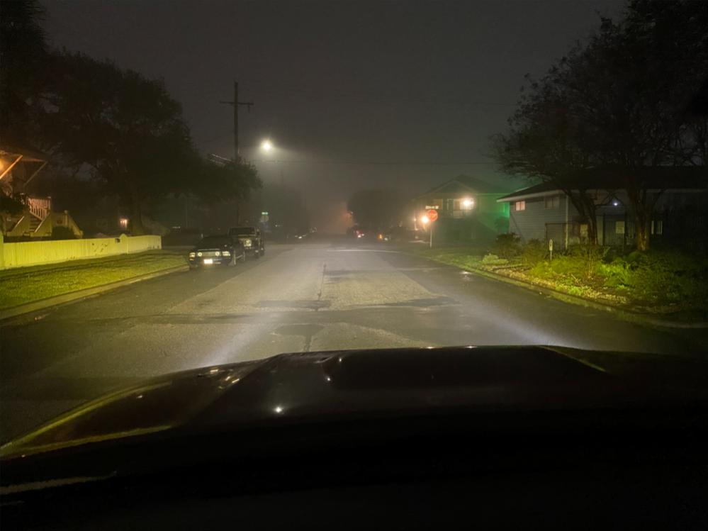

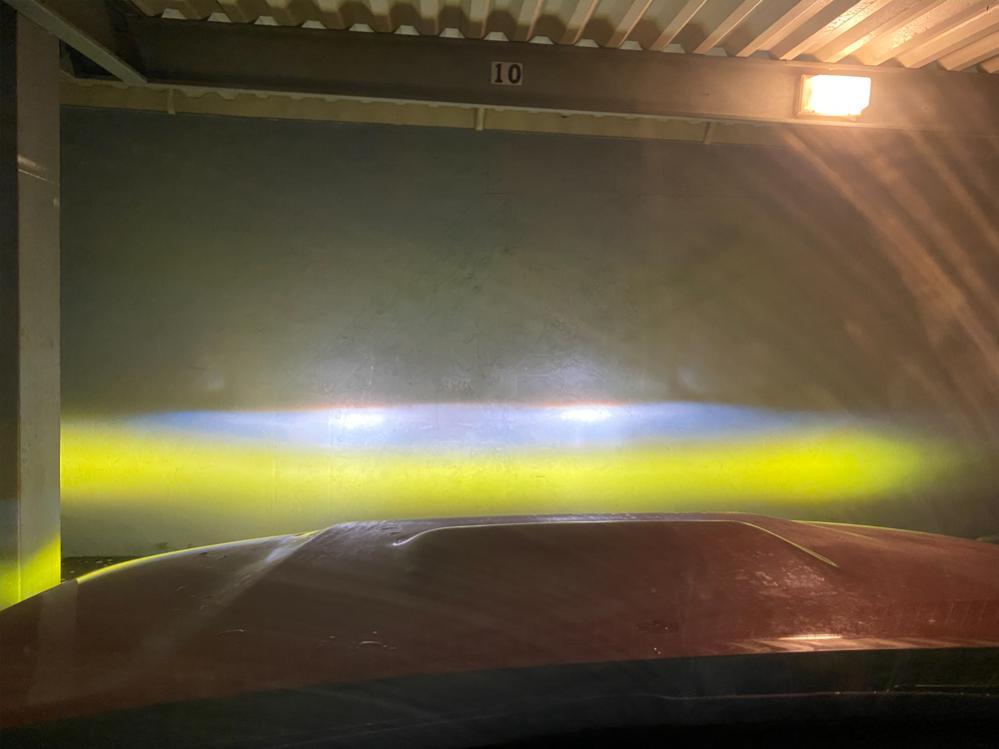

So standard against-the-wall shot to see the separation of the headlights and fog light beam pattern. The fog beams are very wide. That is what is taking the longest to get used to. Directly in front of the vehicle, the fogs and headlights blend pretty well, but if I have a car in the front quarter of me (ie me in their blind spot) only the fogs are illuminating the other car, and the color is distracting. The first time I drove with them on at night I thought there was a lime green car next to me. Turns out it was baby blue. Anyway, the high cut off of the fogs seems pretty good, I do wish I could lower them just a tad more.
5924

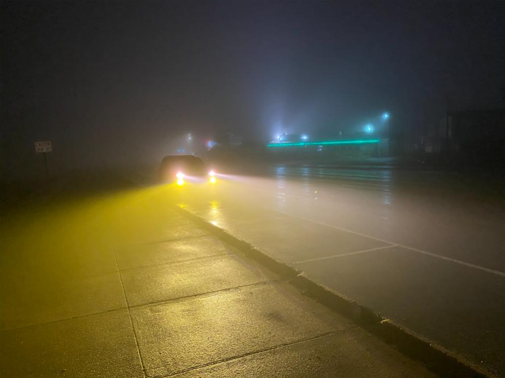

Light beam from the front quarter. I am right on the outside edge of the fog beam.
5935

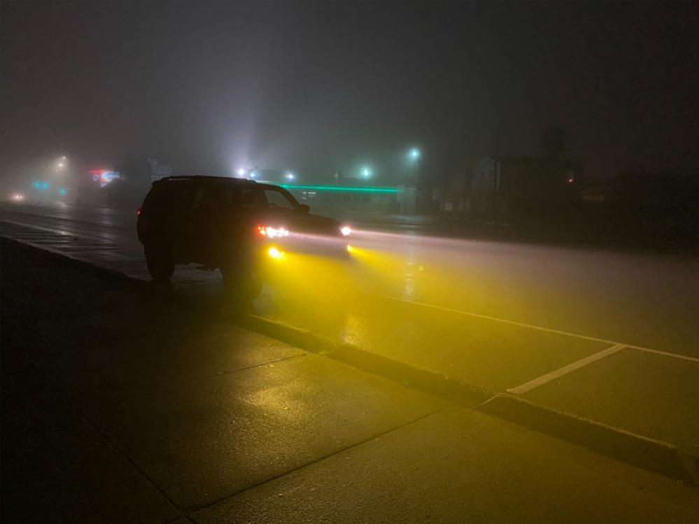

This is on the outside edge of the headlight beam, showing how much wider the fog beam is.
5929

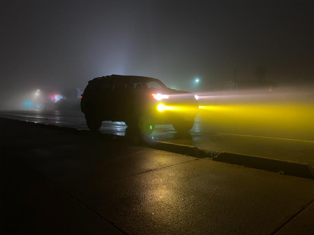

Reverse shot from above. This is from directly above the passenger side headlight. The blue trash can in the distance is just inside the outside edge of the headlight beam. You can also tell how much more reflection I’m getting from the head lights than the fog lights. I’m not sure if that is a factor of the position or the color though.
5927
Side shot showing the separation of the headlights and the fogs. This seems to mostly show that my headlights seem to be aimed too high from the factory, which would explain why the non-LED lights on Toyotas seem to suck so bad.

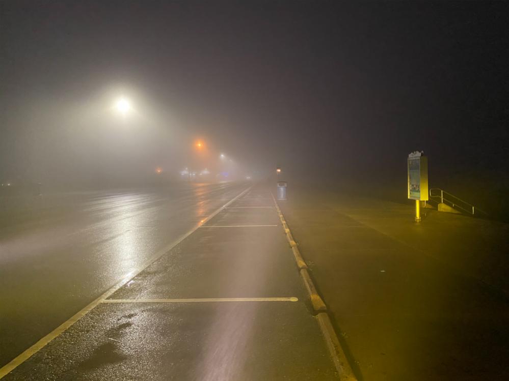

5941
Overall, I’m happy with the beam pattern, the additional width and lighting up the near view is nice. I’m still on the fence about the selective yellow. I also really like the price in comparison to the Baja Designs I was originally looking at, or the Rigids I was looking at after I saw how horrible the BD SAE fogs lights were.
And yes, I’m one of those horrible people that drive around with my fog lights on all the time. Mostly because I can’t see ish with just the headlights on. Maybe I’ll see if I can adjust the headlights down some to see if that will help.

Good review.
Your foglights are aimed too high.
You can move them up or down by pushing on the lips of the foglights outside. If the bumper is interfering with movement you have to go back in and mount the lights as far back as possible in the mounts then try again.
I tightened my down as hard as I could without breaking anything. I'm still able to make tiny adjustments by pushing up or down on the lip.
Good review.
Thanks.
I set them at the lowest possible angle in the bracket before I even put them in the bumper, but I'll go try to see if they move any more.
What are you running for your low and high beams ? They really pop in that pic.
It's probably mostly the camera, but high beams are stock, low beams are the GE megalight ultra halogens. As far as I know they are the brightest halogen option, since I'm hesitant to run LEDs in the halogen reflectors.
GE Megalight Ultra +130 H11 Car Lamps (Twin) | PowerBulbs
They are certainly better than stock, but still kinda crap. I'm going to re-aim them this weekend and see if its better.
