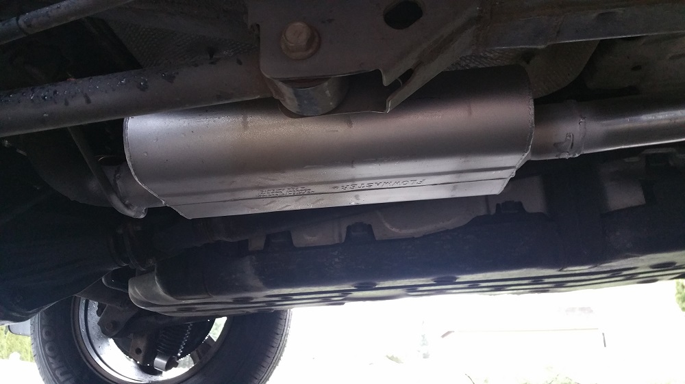

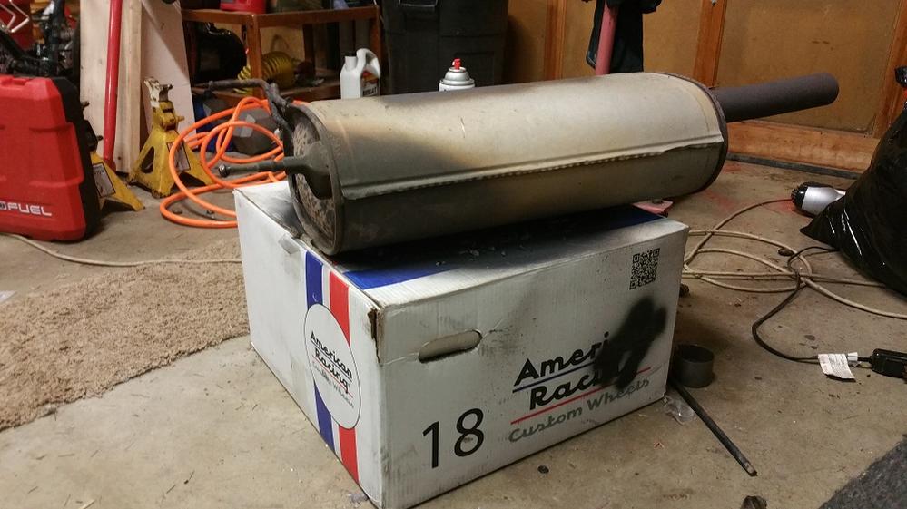

Got two things wrapped up this week. 1, red lugs nuts are now back to stock color and 2...flowmaster!
Removed the gargantuan of a stock muffler in favor of a Flowmaster 50 series (left the resonator and original tip etc.) Ill post a good sound clip later if anyone is interested but Im a big fan so far.
Did you throw that muffler in there with all the stock piping?

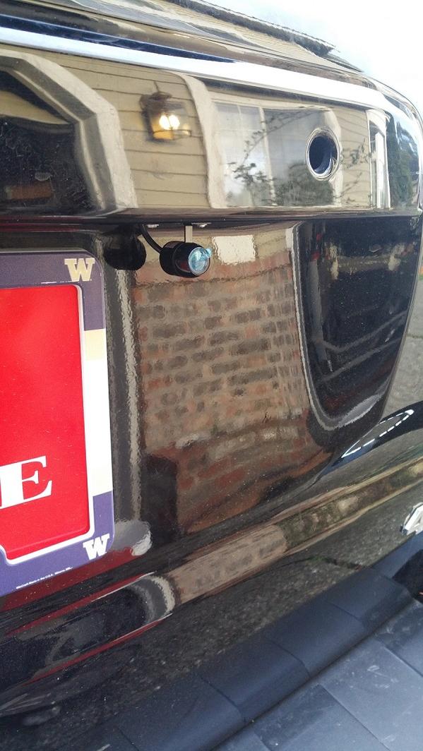

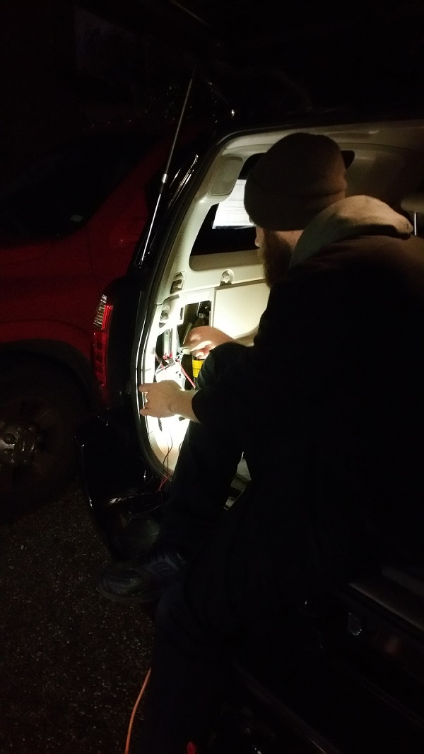

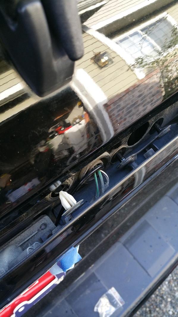

Got one thing done today, finished up routing and wiring in my backup camera. Used and Esky model and ran the wire through the grommet for the hatch release switch then T-tapped into the reverse light bulb for the signal to the head unit. Ill get that exhaust vid up soon, the vid i took today had too much noise pollution so it was hard to hear.

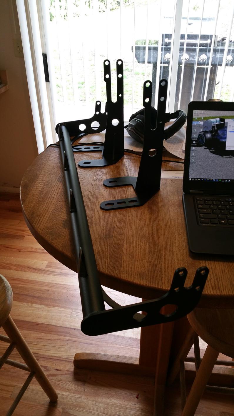

That lower piece looks to be held in my some type of snap clip set up so it might be removable without taking the bumper cover off?
Yes with that style lower grill there are two small bolts and a bunch of little clips all the way around to hold it into place. It can easily be removed without taking off the bumper cover. I just did this to install some brackets that mounted over the bumper support studs to mount up a 30" light bar in the lower grille. Others have just welded tabs to the bumper support and it turned out pretty good but might be trickier with the bumper cover still on.

I found that thread with the light bar behind the grill, if you're still interested. I have a bar on the way and am going to give it a go soon.
http://www.toyota-4runner.org/4th-gen-t4rs/133373-invisible-hidden-30-light-bar.html
Oh nice, yea that looks good. I still havent done anything with that project. Saw another older thread on here where a member is selling brackets that use your bumper mounting bolts to do the same type of hidden mount on the lower grill, or he has a second style that sorta flush mounts it. For his idea you needed a certain size bar that I dont have though.
Yeap think i just saw that thread or a really similar one on here with brackets that mounted that way for about that size of a bar. Looks good
Yep MojaveMadMan brackets, that's what I used. He quit making them, but the idea is a good one if you wanted a bolt on design to replicate for a shorter bar.

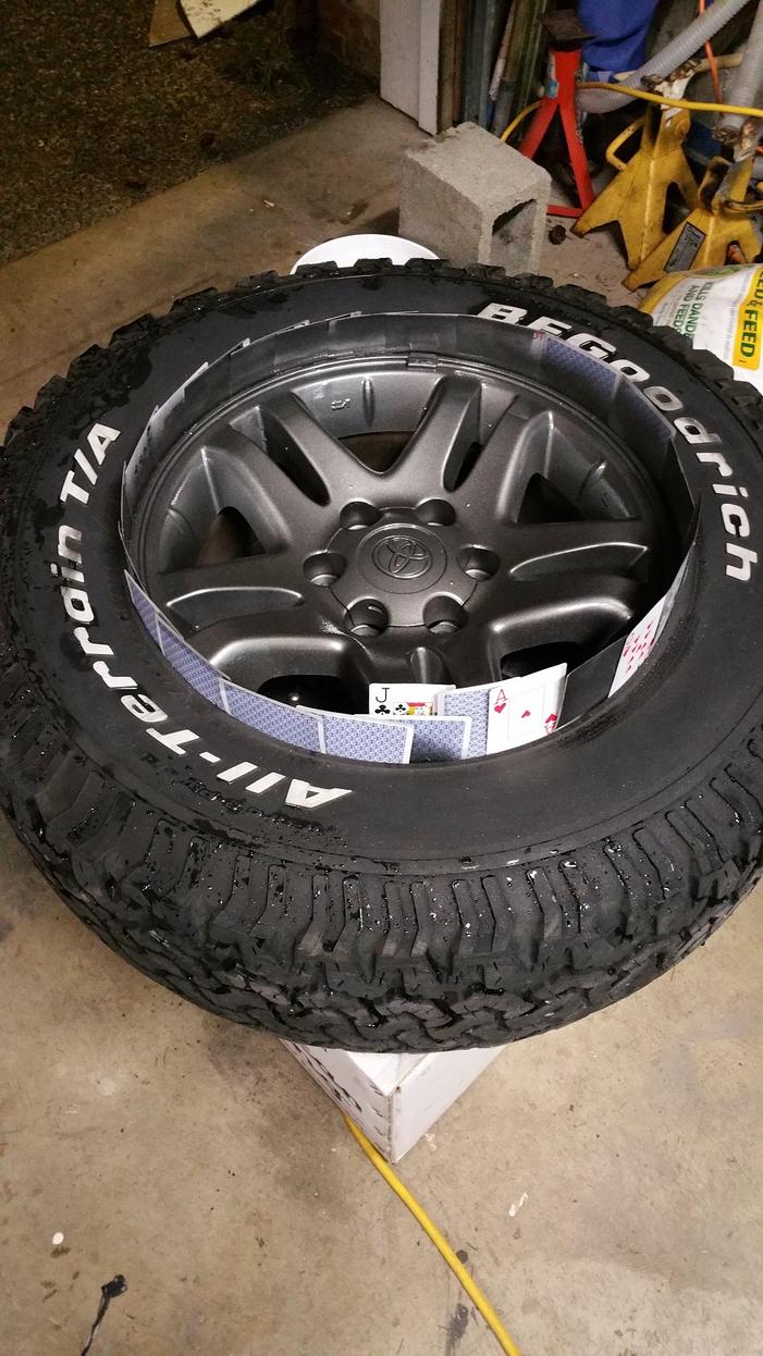

New tires/wheels

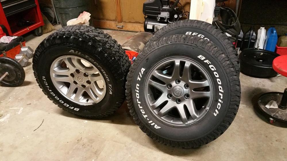

Ended up picking up a set of 06 tundra/sequoia 17" 5 spoke wheels off CL with a set of 265/70r17 BFGoodrich AT's on them. Decided to paint a gunmetal color like I had originally wanted to do on my limited wheels. Going to mount up Friday (Getting TPMS swapped over).
