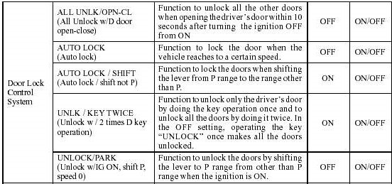

Yes i missed it too at first. each doorlock feature can be turned on or off, so if the one you have on is turned off then they all are off. look again
:awais:
This is the first thing i HAD to fix. It drove me crazy. But now my doors lock only when i lock them. Hope you fix it too.;):

Hey thanks Satman! I must have read that wrong (or the 2003s are different--I hope not) and interpreted it to mean that if you toggled one auto-lock mode off, another would toggle on. I'll try this the first chance I get.

I found with mine that if you follow the directions to toggle the mode you currently have and don't set a new mode, you will have no auto-locking features.
