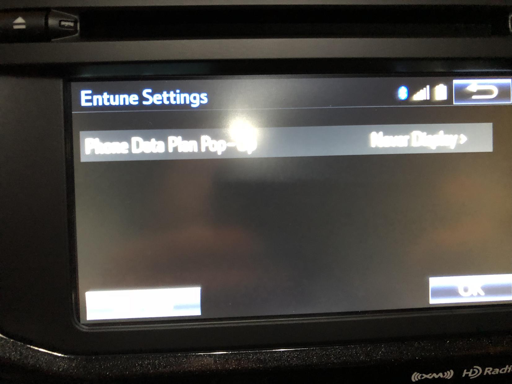

Just got my 2018 4runner and love it. Problem I'm trying to solve is, every single time I start my car, the Entune radio (w/ Nav) pops up a warning message that it uses mobile data.. I have to hit "OK" every single engine start, otherwise I can't see the Home screen.
Any idea how to disable this stupid message? I have unlimited data on my phone so I couldn't care less.
Under Entune app page.

Thank you kind sir!!! Tried nearly every setting, except didn't realize i had a second page of apps to try and reconfigure. Thank you!!
No worries, I remembered doing that while back. I had to go look to see where that was. Just set it and forget it type of deal.
