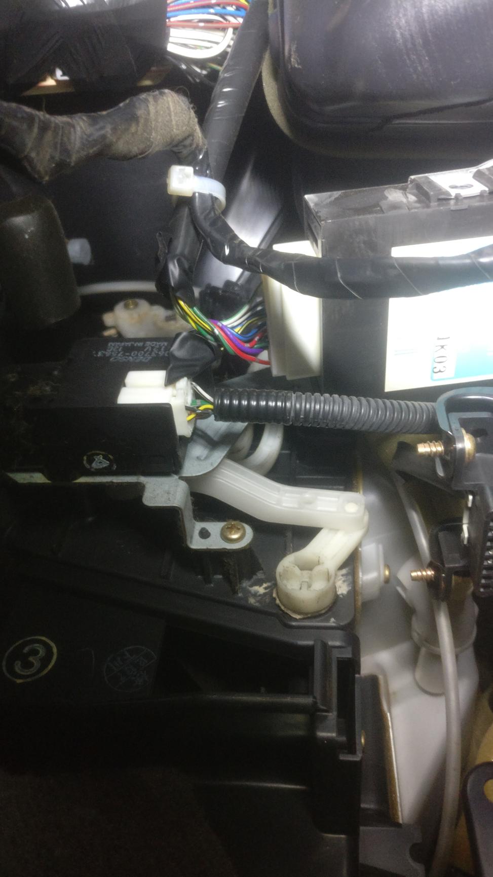

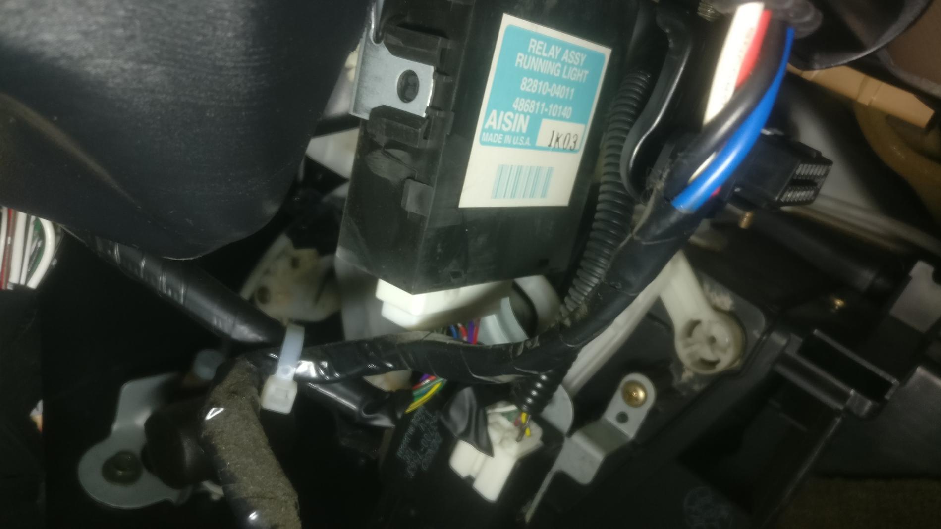

Sorry I couldn't get this pic up the other day but I figured I'd share anyways since my DRL module under the dash looks a bit different. It could be that mine is an 02, either way here it is, under the dash in front of the drivers seat, to the right:
ok yeah mines an '02 so lext4r's looked a bit different- we have that small harness right behind the big Aisin module that also has black/yellow and yellow/black wires, so I ended up cutting the wrong wire the first time. Thankfully got a good splice in there. who knows what I cut, could have been no bueno.
