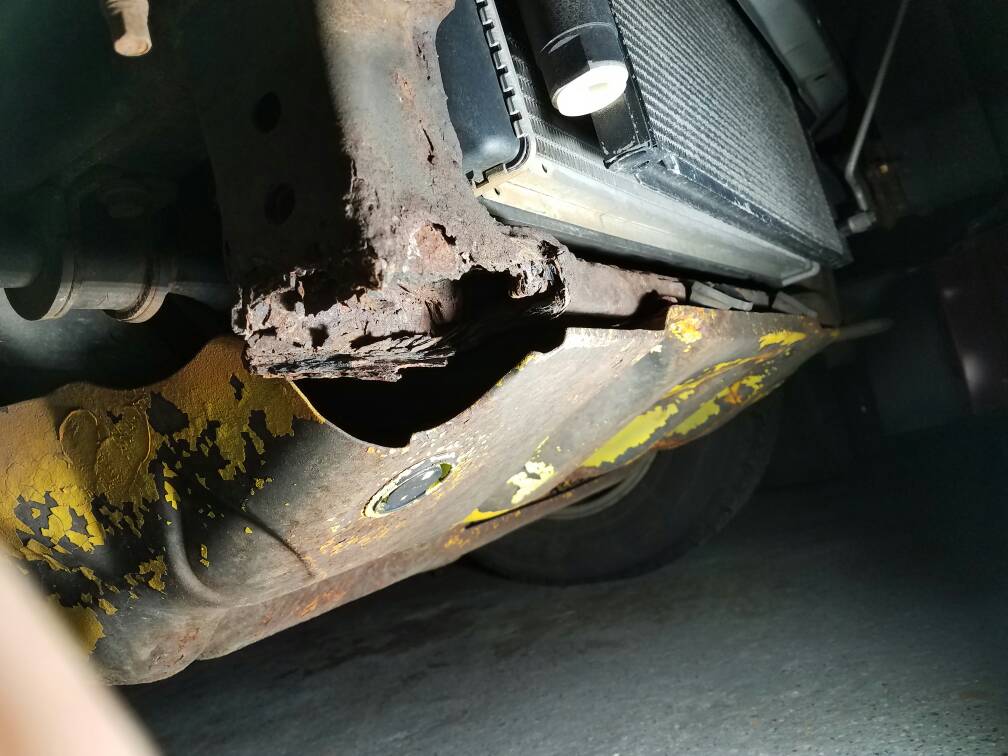

Does anyone had their front cross member replaced? How much did it cost including the parts and labor?
See the picture. Would that pass the annual vehicle inspection?

I had a similar rust problem with my cross member. Mine looked just as bad. I was worried about MA inspection as well. I ended up removing the skid plate and taking a sawzall to the vertical section just above the nasty rust.
My plan was to weld in a replacement, but got sidetracked on that. Your mileage may vary, but mine passed inspection without any issues. I will take on the repair in the spring, probably adding an aftermarket skid as well.

Can't say specifically for the 4Runner, but someone I know paid about 1k to have the equivalent piece replaced on an Expedition because it required sourcing the part from a wreck, cutting out the rusted piece, and welding one in. If mine ever gets that bad I'll do the cutting and welding myself since it only really holds the transmission cooling lines and skid plate. I suspect he overpaid at that price.
As for passing inspection, in MA (and I'm sure most states) it completely depends on the shop. One place won't even look at that, and another place will tell you the car is unsafe and should be scrapped. Best bet is to find a place that isn't too picky, or just find a good fabricator and get it fixed beforehand.

I did that repair on my '03 SR5 two years ago. You can get the cross member from Toyota (I think I paid about 275 for mine), and I had a shop that does vehicle frame repairs cut the old one out, repair the rust damage to side frame rails, and weld the new cross member in place for 250. It came out nice. I finally sold it when I acquired an '03 Limited V8.
As for the inspection, it depends on the state involved. In NY, I had no problem getting it to pass inspection prior to the repair, because that cross member does not support any suspension components, it only serves to hold the skid plate and transmission cooler lines in place. Other states may have different requirements.
fellow M******* here. I have the exact same problem on my frame. if yours is that bad, you may want to check the transmission fluid cooler lines that run along the top of it. while i was inspecting my frame rust, my lines disintegrated in my hands and i had to replace them on the spot. that sucked!

You are right. That cooler lines are so rusted too. It's just a matter of time before completely failing and end up damaging your transmission due to oil loss. I replaced that too and now confident it will last another long time. Thanks.

I'm in the same boat. 2003 T4R started loosing that piece at 120k miles. It's mostly gone on the passenger corner now. I hit it hard with a grinder and flapper disk and rust reformer when I got it 2 years ago. Basically stopped the loss hard, but it's not something I'd use to pull the truck out of a ditch from.
