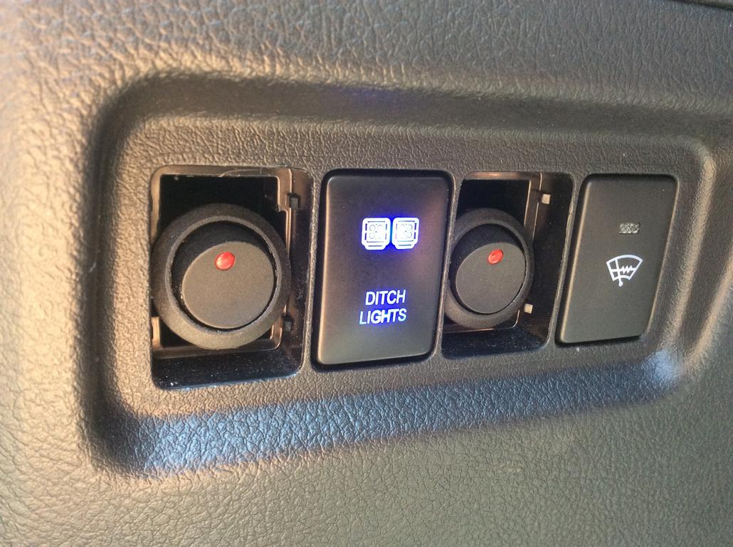

I found the wiring diagram on their website. Quick question. My switch doesn't seem to dim with the rest if the instrument lights. I hooked it up to the green wire on the wiper heater. I just wanted to know if I installed it incorrectly.
Melissa from ragofabrication confirmed that they do not dim.

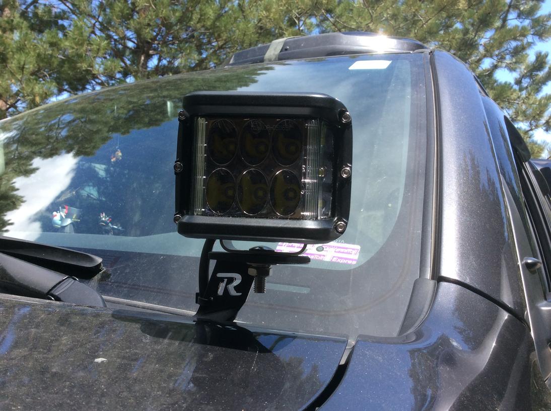

Here is my install, looks good. Just need to adjust when it gets dark.

I had the same issue, called rago, and learned my red wire and green wires from switch harness needed to be switched
