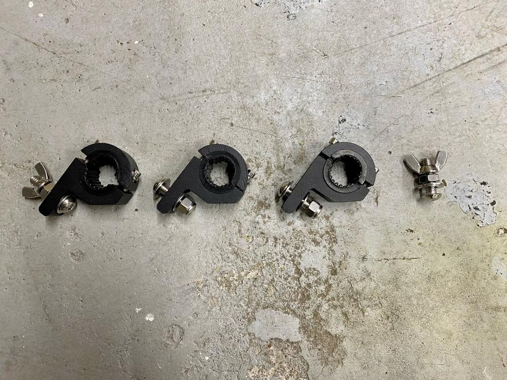

First, I got some tube clamp mounting brackets that were advertised for mounting off road lights to a bull bar:
Then I added my own fasteners:

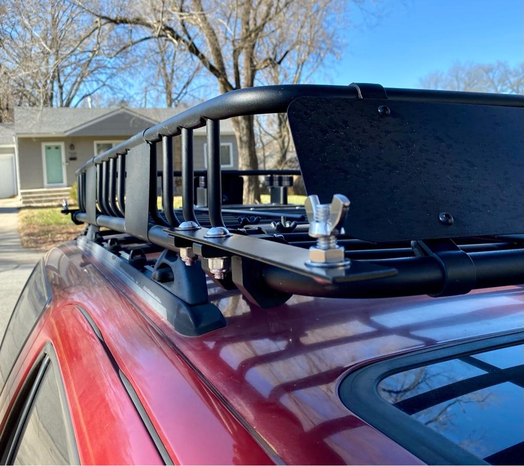

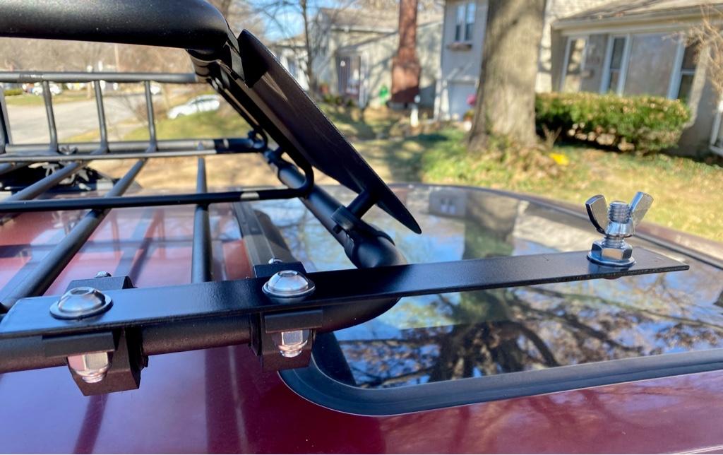

Then I cut/drilled/painted a steel bar so I could extend the front bracket to the length I needed and mounted it up:
For the awning, I just use a normal 5x7 tarp, two telescoping aluminum poles, and then guy it out with some paracord and tent stakes.
Just put the tarp grommets over the upward facing bolts and spin on a wing nut. Then guy it out.

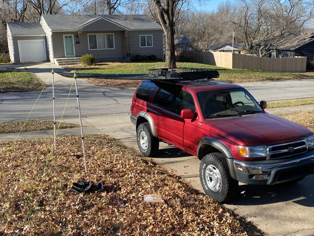

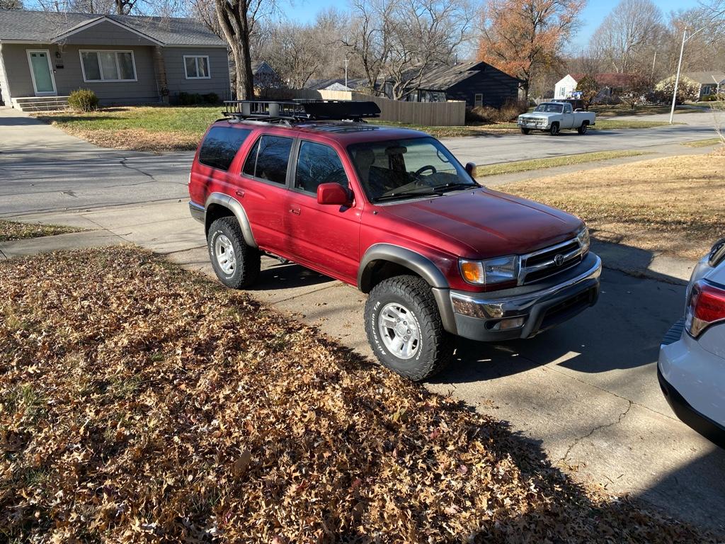

Here’s what it looks like set up:

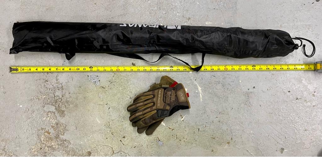

The brackets weigh a total of maybe 1 pound, and the tarp/poles/stakes/paracord all weigh about 1 pound.

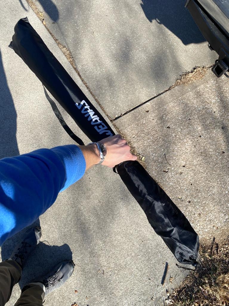

Everything you need is in this bag. Tarp, both poles, stakes, and paracord:
Setup takes 1 person less than 2 minutes. Tear down is even faster.

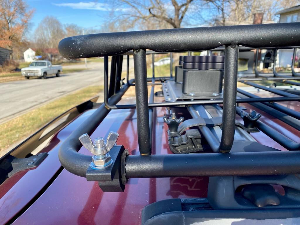

And because only small brackets remain on the roof basket, there’s nothing up there to add weight, drag, and nothing to tempt would-be thieves when you’re not using it.

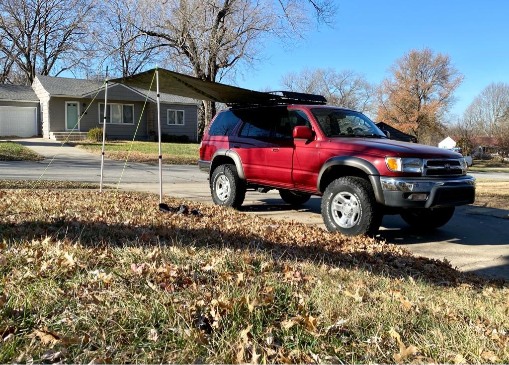

Here’s what it looks like torn down:
