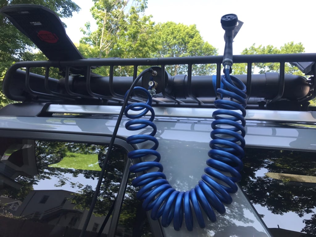

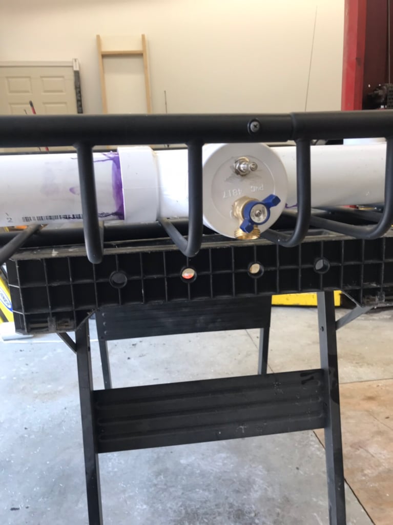

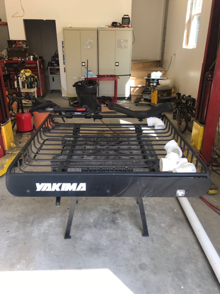

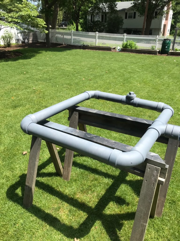

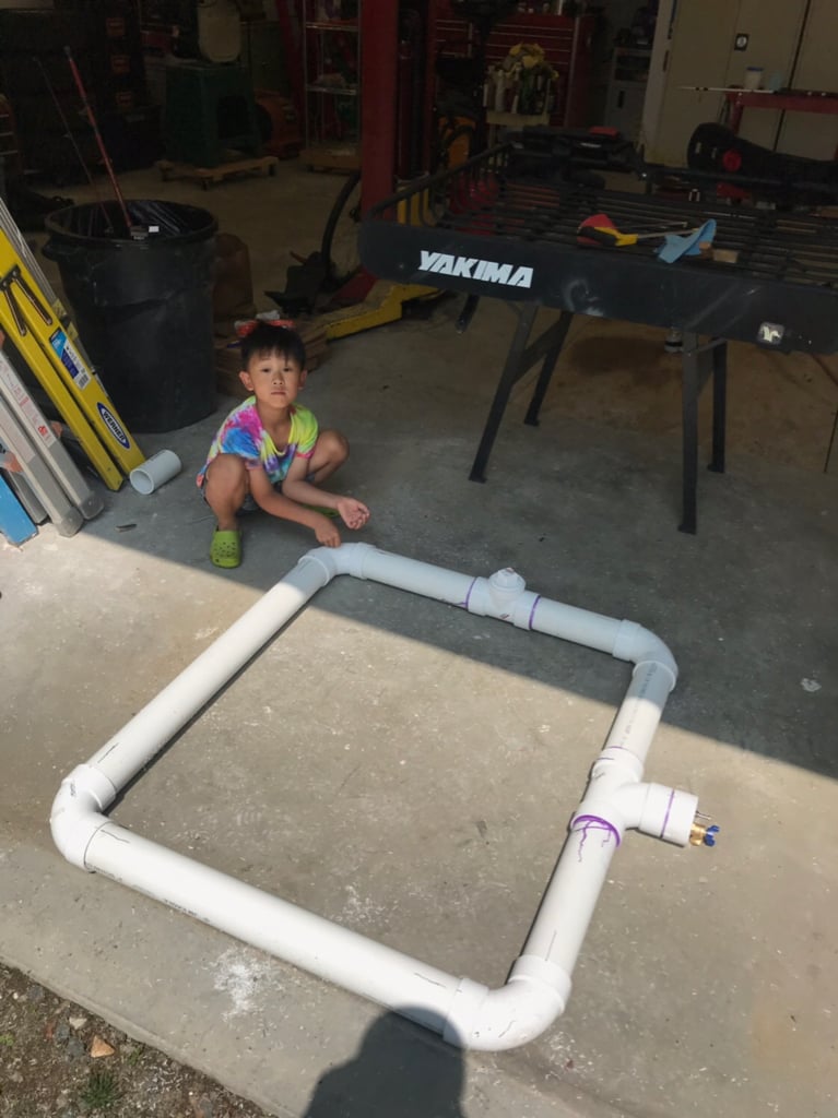

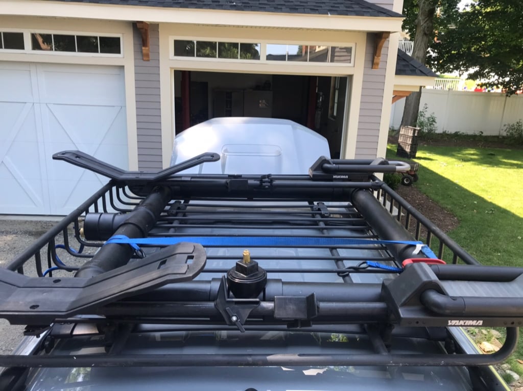

I don’t post much, but wanted to share my take on the pvc solar shower. The ones I’ve seen were just ~10’ of pipe slapped on top of the roof. Good idea, just looks bad to me. I wanted the same thing, but more integrated. Since I almost always leave my Yakima Megawarrior on top, I figured I could nest it into the basket. Here it is

also, only running 20psi. I have a pop valve to regulate it for extra safety.
i built something similar but a 4' long 4" section of piping. Thinking about modifying it so that I can attach a quick connect instead of the traditional screw on hose fitting.
Also, I have a bunch of CO2 that I use to carry whilst cycling, might be interesting to attach the CO2 bottle to the valve to run pressure to it while using the water.
