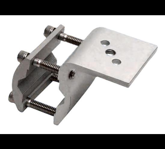

I'm thinking of popping holes on the outter edges of my RTT and mounting these Tite-Lok Rail mount bases on 4 corners and securing it to the outter 1" rail of my Baja rack. With a impact, I could pop of the securing plates from all 4 corners in less than 2 minutes then lift it right off the rack. Securing the actual brackets onto the RTT, i'd use a thicker bolt with fender washers on the inside or go as far as sandwiching a metal plate on the inside of the tent.

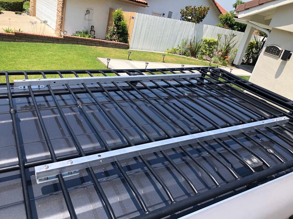

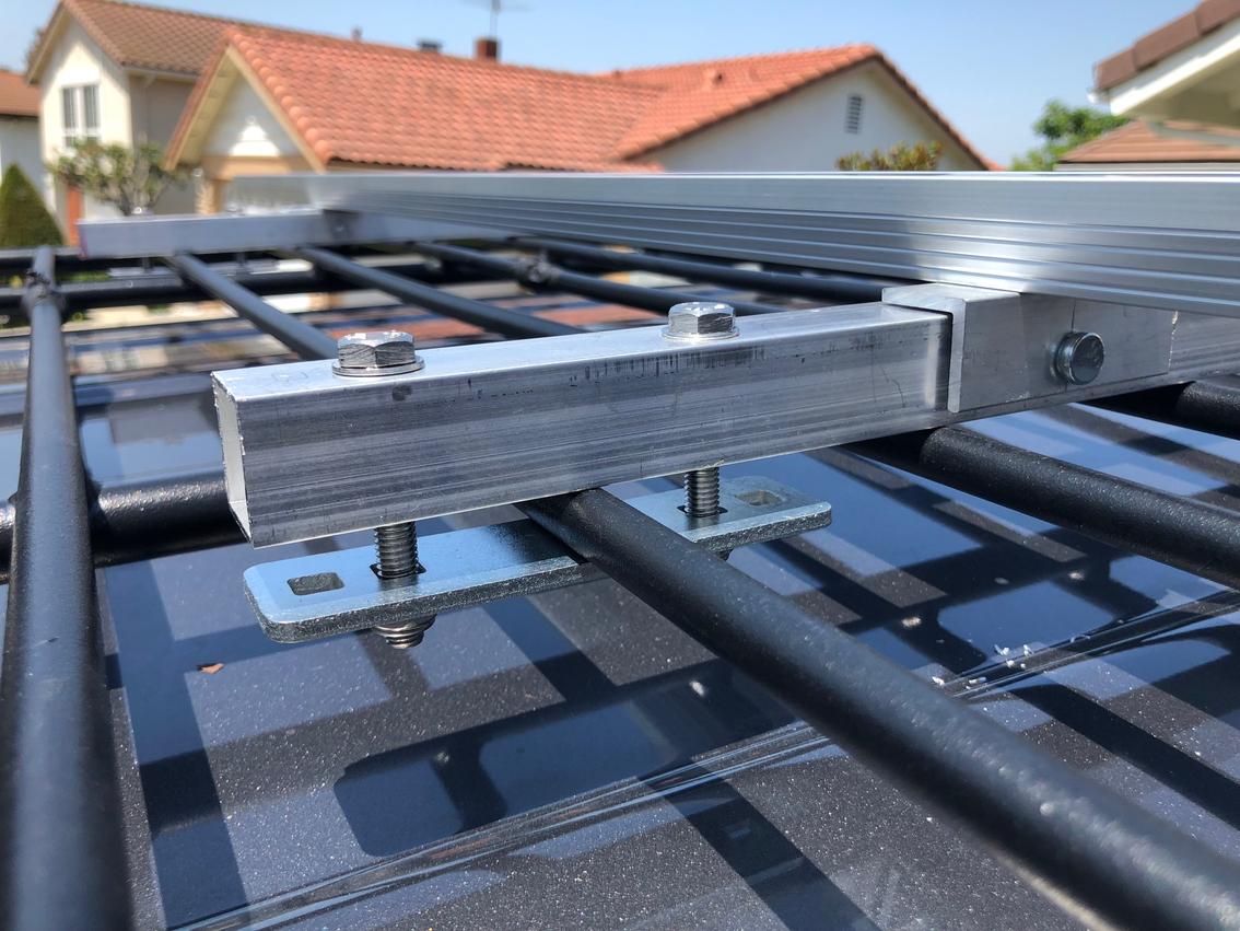

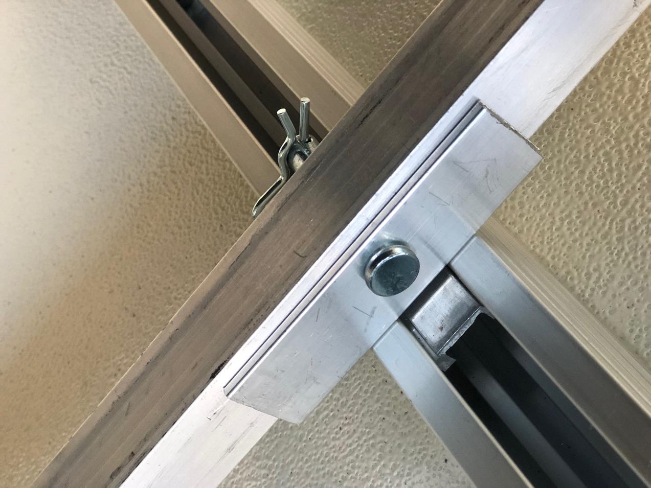

Quick update. Ended up going with this type of setup with quick release pins. The rails are 1" aluminum. The pictures are self-explanatory but if you have any questions let me know. Since I took the picture, i tightened up the L brackets against the rail so ignore the slight gap in the picture.
I'm going to put it through a little trial run before I pretty things up by painting the hardware and sanding off the brackets. The tent going on is a Smitty overlander.
Thus far the thing is solid. I tugged the living hell out of this thing with all my weight and it doesnt budge one bit - i'm debating on adding another rail in the middle to create a "H" type setup to reinforce any lateral movements from the rails. As for noise, the only bit of noise is where the L brackets meet the rail. I'm going to pickup some felt pads which will quiet things up. I end up killing a few birds with one stone going with this type of setup. The additional 1" of height allows my RTT to clear my ARB awning hanging off the side and this also adds the necessary height for my snowboard rack to carry 4 boards instead of 2.
All in all, materials were about $80 from local hardware store. I measured and cut it all up in my garage. The only thing i will eventually swap is a quick release pin with a T handle so its easier for me to reach under and yank it out but I picked up what they had in store for the time being.
