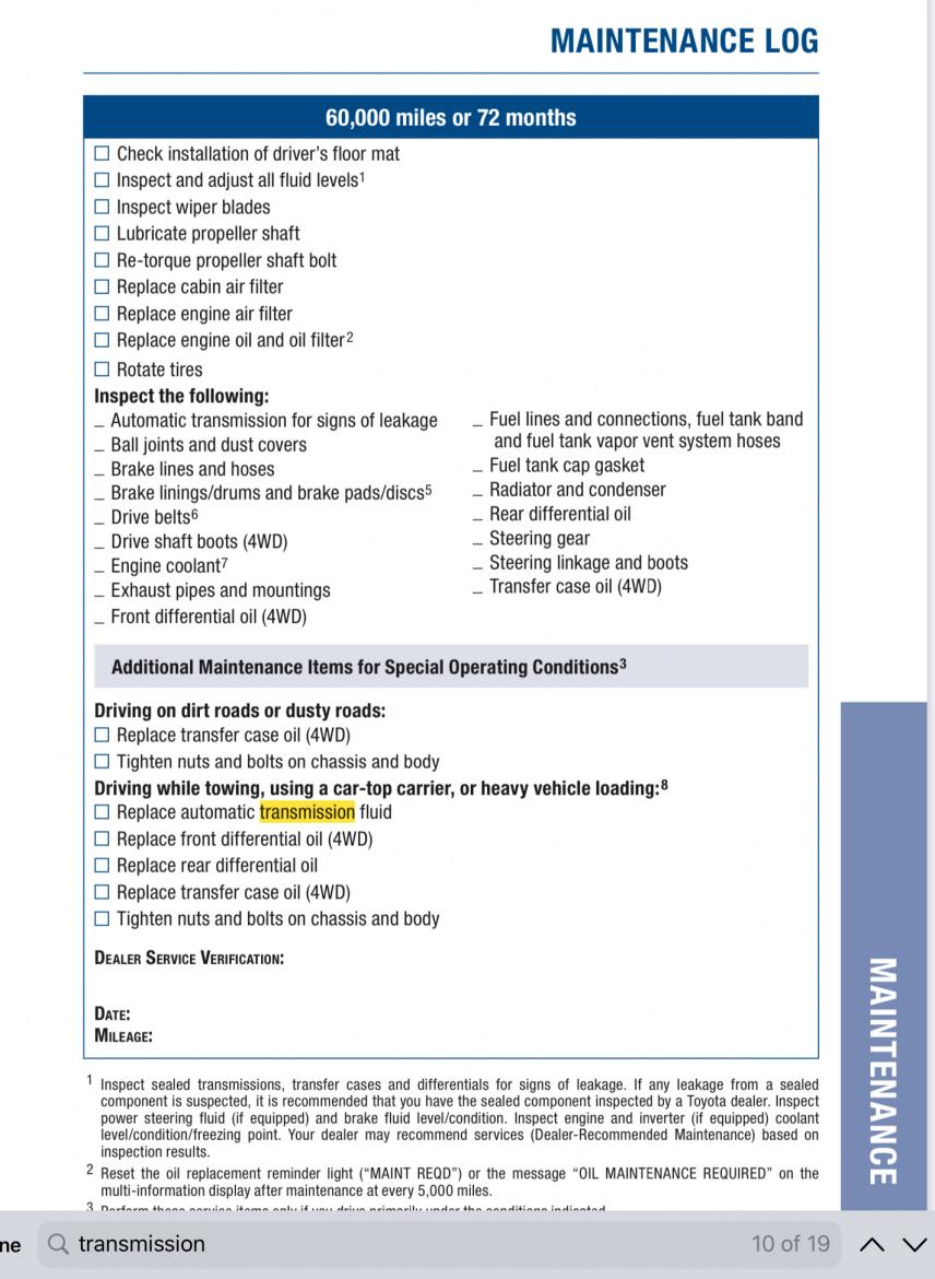

If you look at the history of the 750F transmission you’ll see they tend live a long time with minimal maintenance.
Other than looking for leaks, this is the first time the transmission shows up in the Maintenance guide (2020)...
Interesting, I wonder where my mechanic got the idea to flush mine. So if I had mine changed at let’s say 35-40k I should be good to go for quite some time. I’m not going to mess with it. And I do not tow anything with it.
