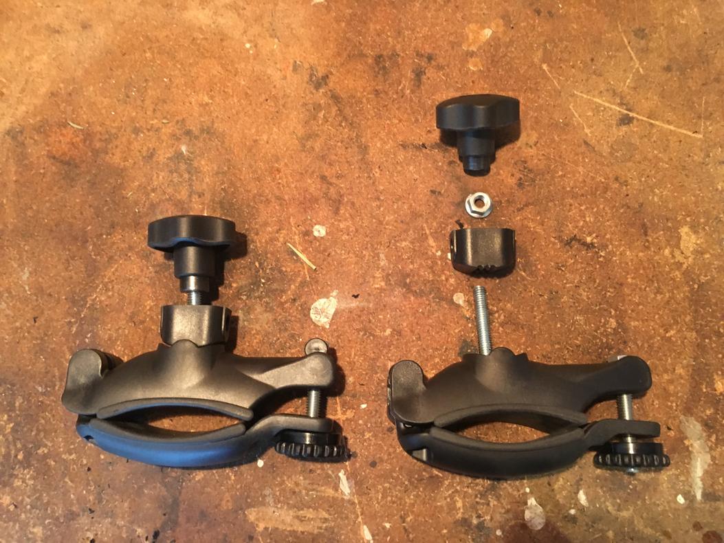

For both the mounts I assembled the mighty mounts with the shorter arms needed to fit the crossbars of the 5th gens.

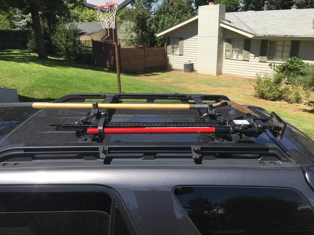

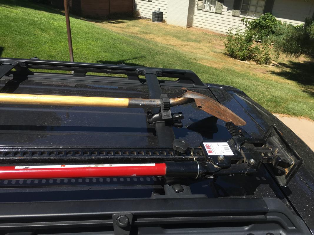

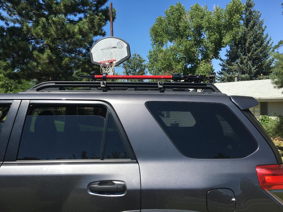

For the lift mount I used the taller of the two available spacers (For lack of a better description) to help the lift fit on the mount correctly. In the top part of the mount use the 2 1/2" carriage bolt and put it through the mount then the spacer. Then thread on one of the lock nuts that comes with the might mount assortment of hardware. I didn't tighten this all the way due to it's need to move to seat correctly and the difficulty of tightening it. At this point the hi-lift mount is ready to go. I placed the rear crossbar as far back as I could without the base of the Hi-lift hitting the hatch door in the up position. Also to center it more to standing on the rear wheel which is where I will be when removing etc.
I placed the front crossbar forward enough to spread the weight of the lift evenly and for the mount to reach an available hole in the hi lift

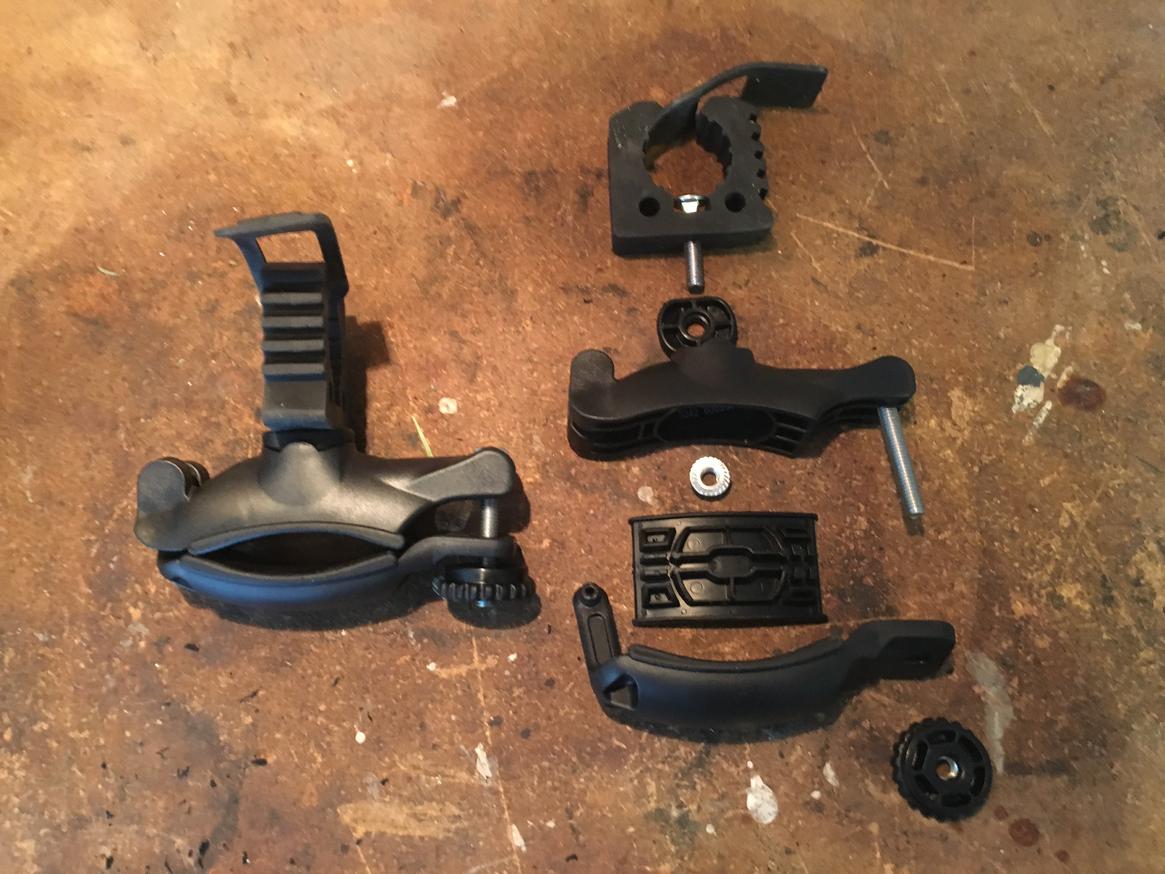

For the shovel mounts I first widened the hole in the base of the quick fist with a 1/4 inch drill bit and forced one of the 1 1/2" carriage bolts that comes with the mighty mount kit down through the quick fist. I then inserted the carriage bolt through the smaller spacer and into the mighty mount. Next I tightened it down with one of the included lock nuts. At this point the shovel mount just needs to be attached to the crossbar and mount your shovel.
I hope someone find use of this and I am happy to answer any questions or criticisms.
