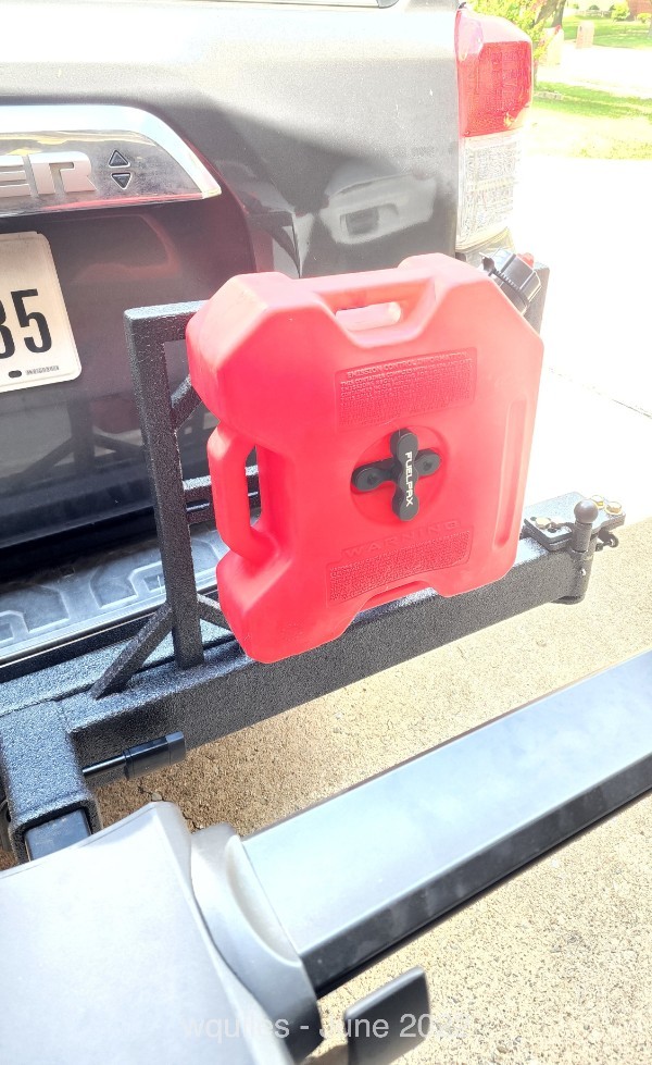

I been wanting to make something like this:
or this one:
But I also wanted to make something stronger enough that could be used to carry a heavy spare tire as well, like this one:
So I spent months looking at videos, photos of about 10 different options, including some DIY designs, trying to come up with a version that had the features I wanted for my Toyota 4Runner. I actually started thinking about this project in late Summer, early fall of 2021, so it has been almost a year since I had the original idea for this project.

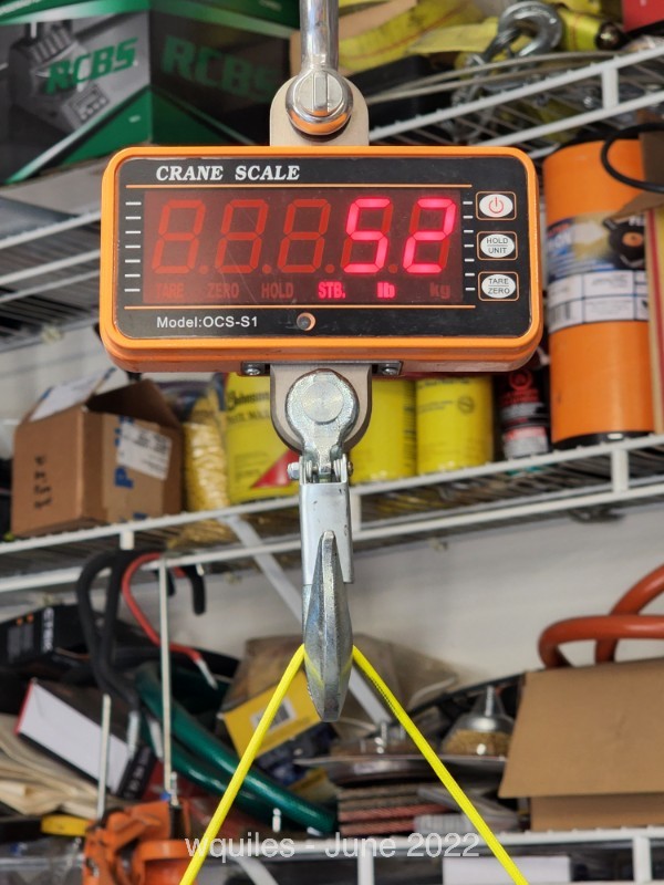

Completed weight came to between 52 and 53 pounds:
The accessory mount can hold these of course:
and in the future I plan on completing the mount for the spare tire, along with a way to bolt it in place:

I initially thought about doing this summer of 2021, so today is July 2022, and I am finally done!
Total cost was about $250 for parts, primer, paint, supplies, etc.. - still a lot less than the $1500 for the top-of-the-line model, and I would argue mine is probably strong enough.
I have a little to tweak, and touch-up paint in a few places, but I am pretty much done for now ;)

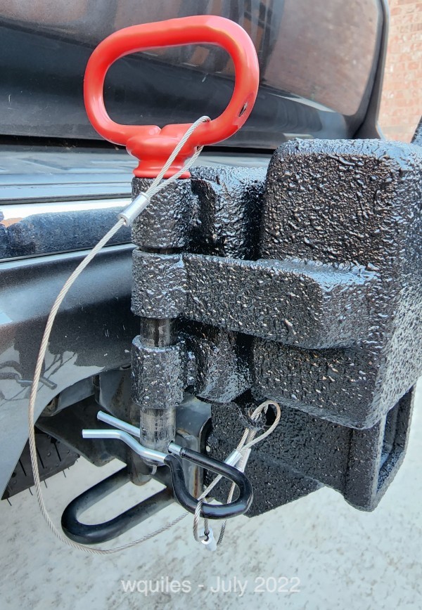

The project is finally starting to take shape. Got the hinge and the latch delivered about a week ago, had the hitch test mounted and fab’d the first few pieces and welded the hinge backing plate and put a coat of paint on it. Next comes the swing out arm and the gas can carrier bit.
