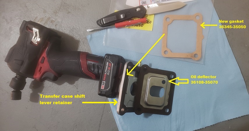

Part numbers:
1 x Oil Deflector 36108-35070
1 x Gasket 36345-35050
A note about the parts above: Most things I read said you need 2 gaskets. This is not true if you buy the oil deflector. The oil deflector has a paper gasket just like the gasket above built into it. This part is listed as non-reusable by Toyota but some people have reused it. You just have to be careful not to bend it, and make sure you get all the old gasket off. I recommend just buying the deflector, but do whatever you feel is best for you. If you buy the deflector you only need one gasket. If you do not buy the deflector you will need two gaskets. I just want to make it clear so no one gets halfway through the job and has the wrong parts.

Part numbers:
Side note to clear any confusion, the order of the parts should be like this: Transfer case, paper gasket built into oil deflector, oil deflector, paper gasket, shifter.
Great info. I found the transfer case shift lever gasket and oil deflector on a parts diagram but wasn't completely sure I had the right part numbers until I saw your thread.
