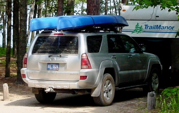

I have two 12.5' recreational kayaks. I use Yakima low rider towers with two 60" (I believe) round cross bars. I used aluminum bars rather than the Yakima steel ones. On the cross bars I have located pipe clamps that route the straps so that each kayaks is secure separately at two places. With the kayak upside down one of the cross bars fits into a natural groove in the kayak just behind the cockpit to keep it locked in fore and aft.
