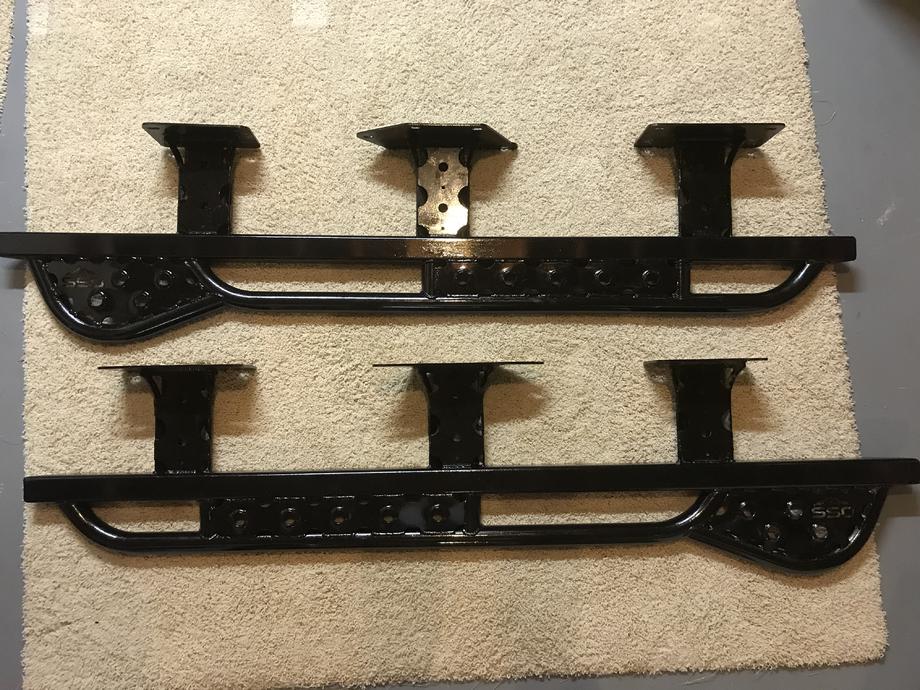

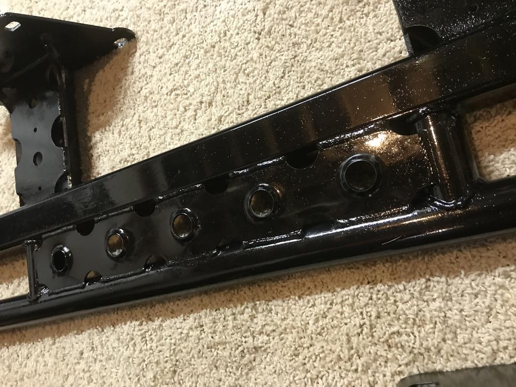

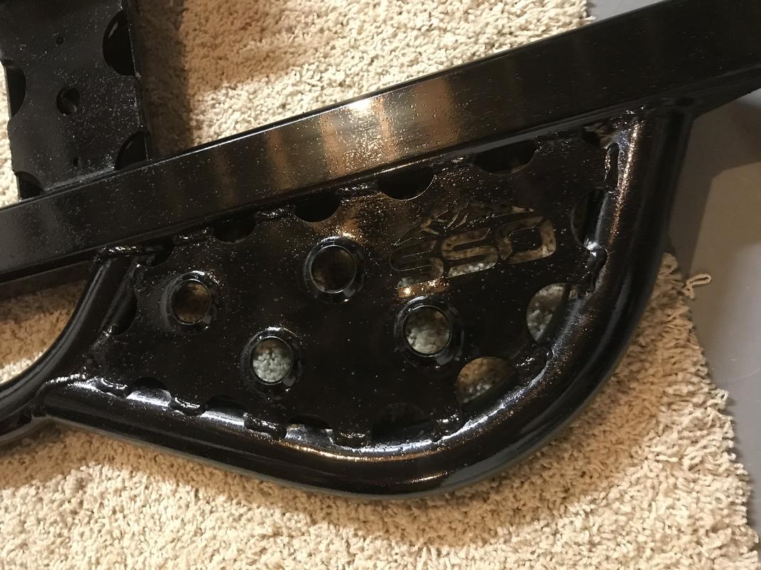

Here are some pics of the sliders after applying POR. I will post more after the top coat is finished. I should only have to worry about touch up on the top coat for any repairs as the undercoat is very hard and won’t scratch, flake, or chip. My finish is had a little texture due to some of the foam roller coming off in the process. I am not too worried about it but if you want it smooth I suggest using a brush to apply it.
