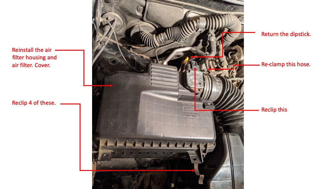

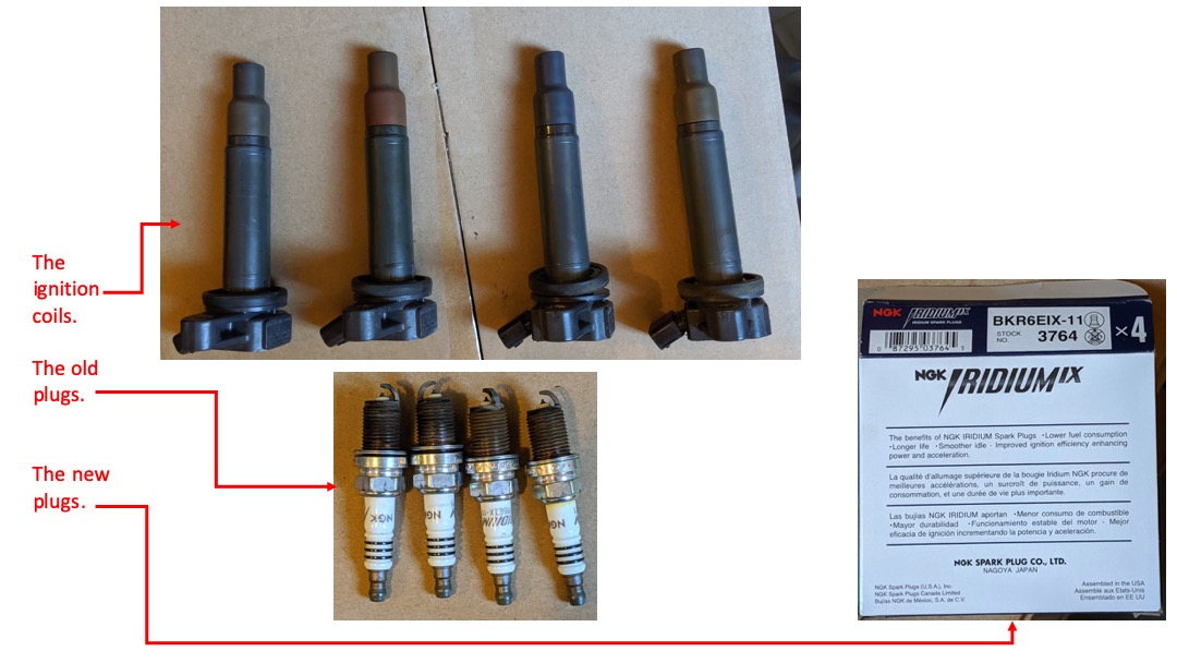

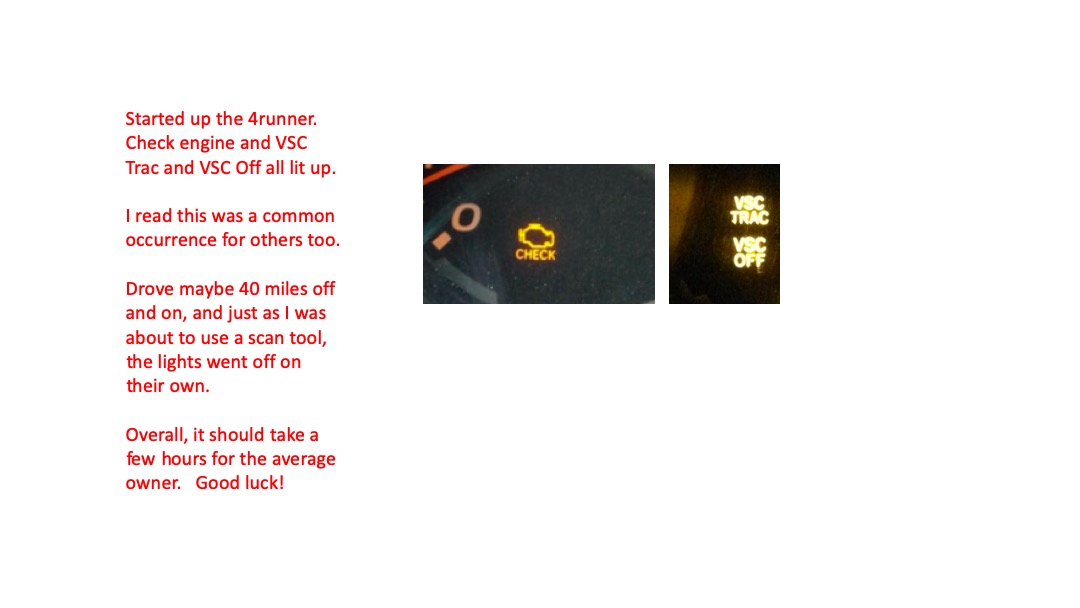

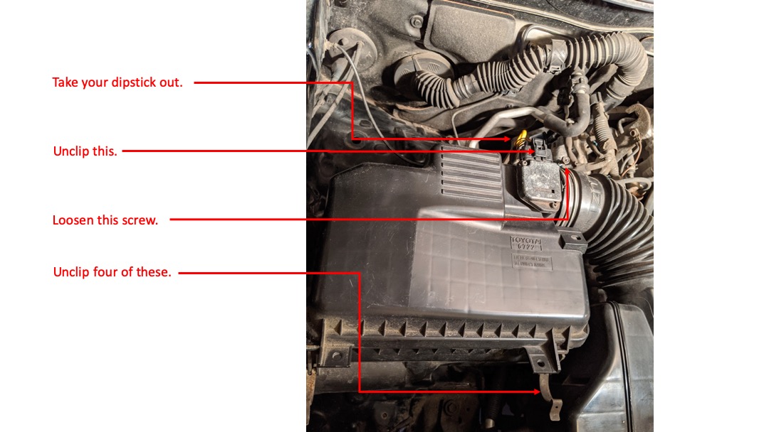

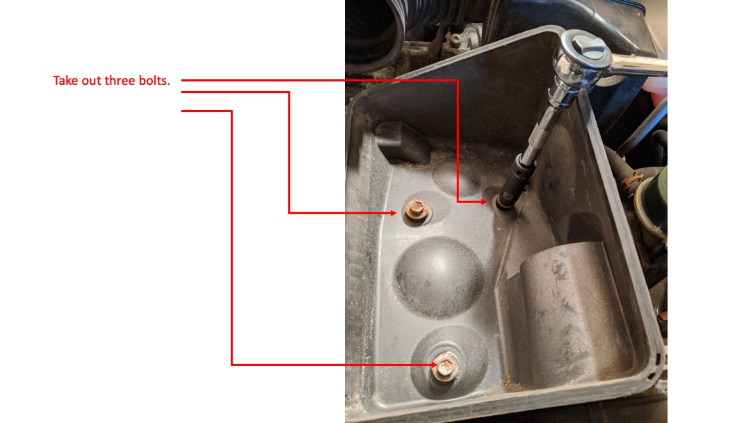

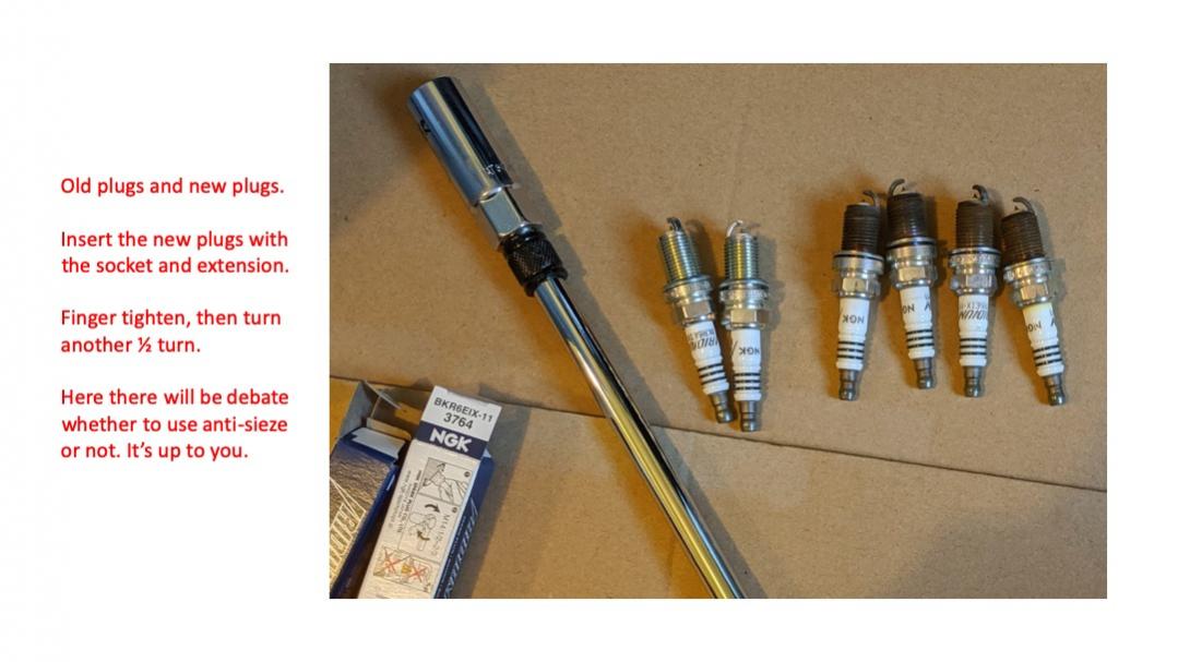

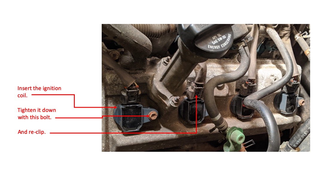

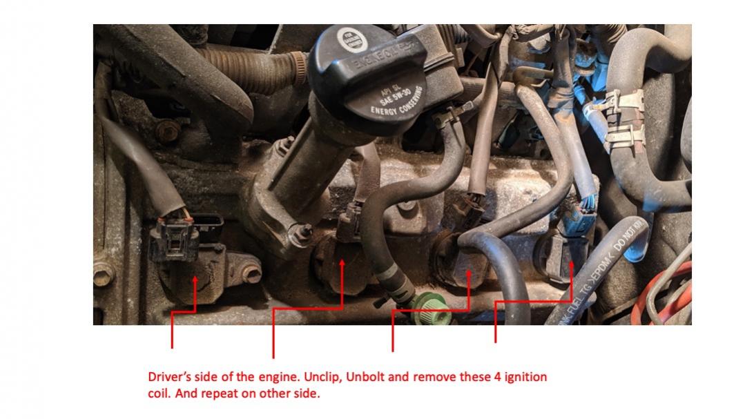

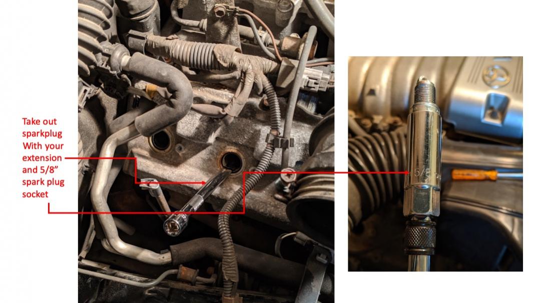

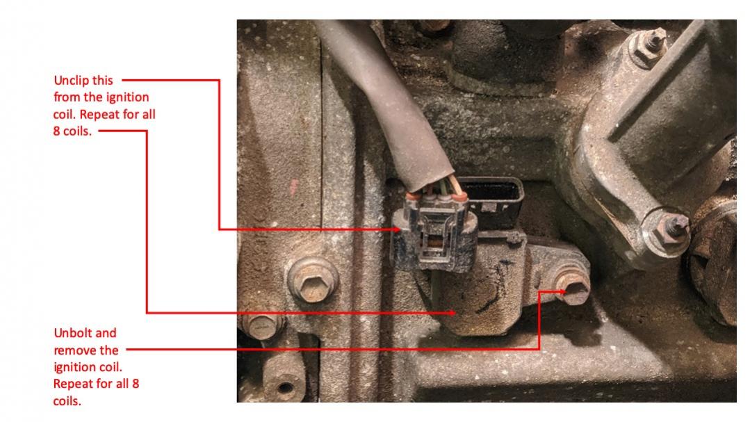

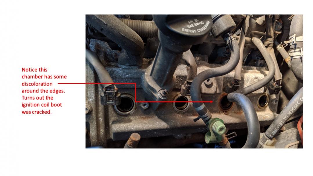

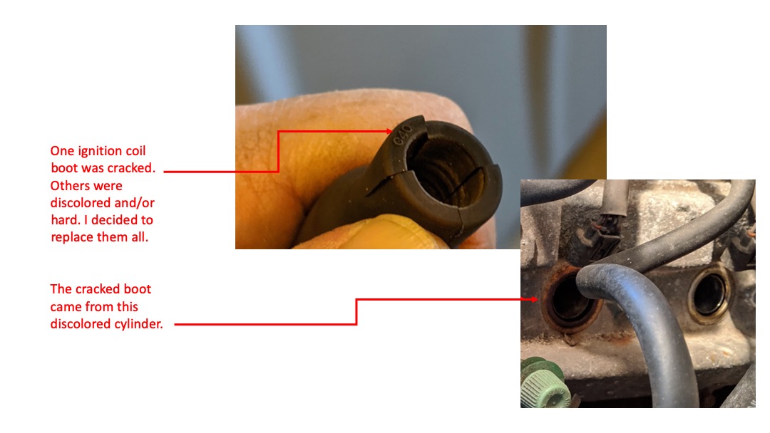

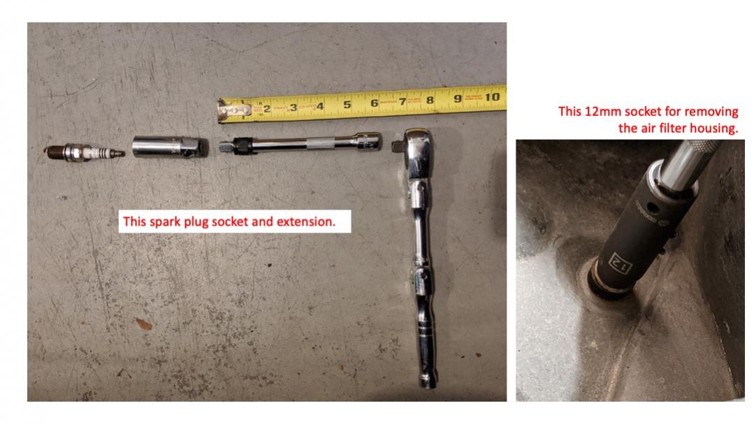

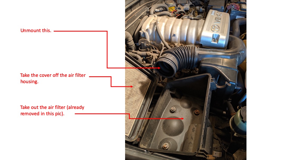

I have 186K miles on my 4Runner (‘04 V8).
The spark plugss were last changed with the timing belt at 116K miles.
There were no issues but I decided to change the plugs after 70K miles. I ended up changing the ignition coils too.
I hope some will find this DIY helpful.
to be continued...

The spark plug duration depends on the type of plug, copper plugs are good for 30,000 miles, iridium last much longer.
Usually the V6 engine uses copper plugs..but some owners use the iridium plugs instead, the V8 engine uses iridium, I don't think you've mentioned which engine you have, or which plugs were installed?
Thanks for posting! I had been looking for a guide that showed how to remove the air box. In regard to the spark plugs, I've noticed a debate between ngk and denso plugs. It seems as though people typically go for denso on most parts for the the 4th gens but spark plugs are the rare exception to go ngk on. Anyone have thoughts on this? I just bought an '04 with denso plugs that only have a few hundred miles on them. Unsure if I should keep them in or swap them for NGKs
If they're genuine Denso, keep them, they're good plugs, it's what I run in my V8 T4R.
