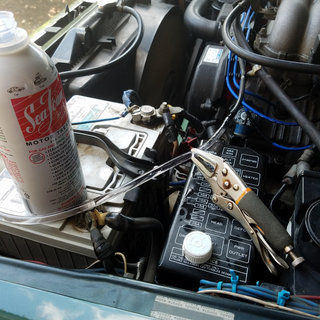

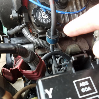

A few years ago when I bought my rig and before I started on any of the T4R forums, I had the dealership do what they call the “top end clean”. I remembered how they did it and duplicated it. It works like a champ and it seems to be better than pouring the Seafoam in the PCV vacuum tube.

Is this different than using the Seafoam can that comes with the adapter to be applied through the throttle body?
does it suck the sea foam out on it's own?
I will try and answer both questions at the same time. This is not the same as going through the throttle body with seafoam. It actually goes past or behind the throttle body directly into the top end of the engine.
The seafoam is pulled in on its own, but you have to slow the stream down. At least I had to because the hose I was using was about one quarter of an inch, and it was pulling it in too fast. That's why you see the small pair of vice grips. I was able to slow the flow down, and it worked like a champ. Much more smoke than you get my spraying in through the throttle body, or through the p CV valve.

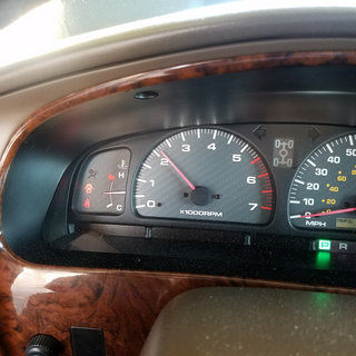

By slowing the feed of the Sea Foam, I was able to meter it into the top end. While running the truck at about 2200 RPMs, it slowly sucked the seafoam into the top end of the engine. The whole process ran for about 8 minutes straight. For every one of those eight minutes, there was plenty of smoke.
