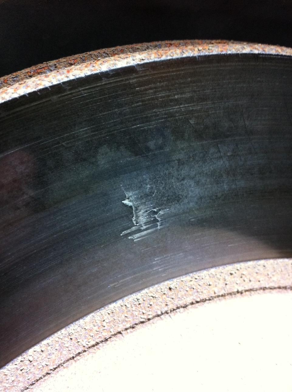

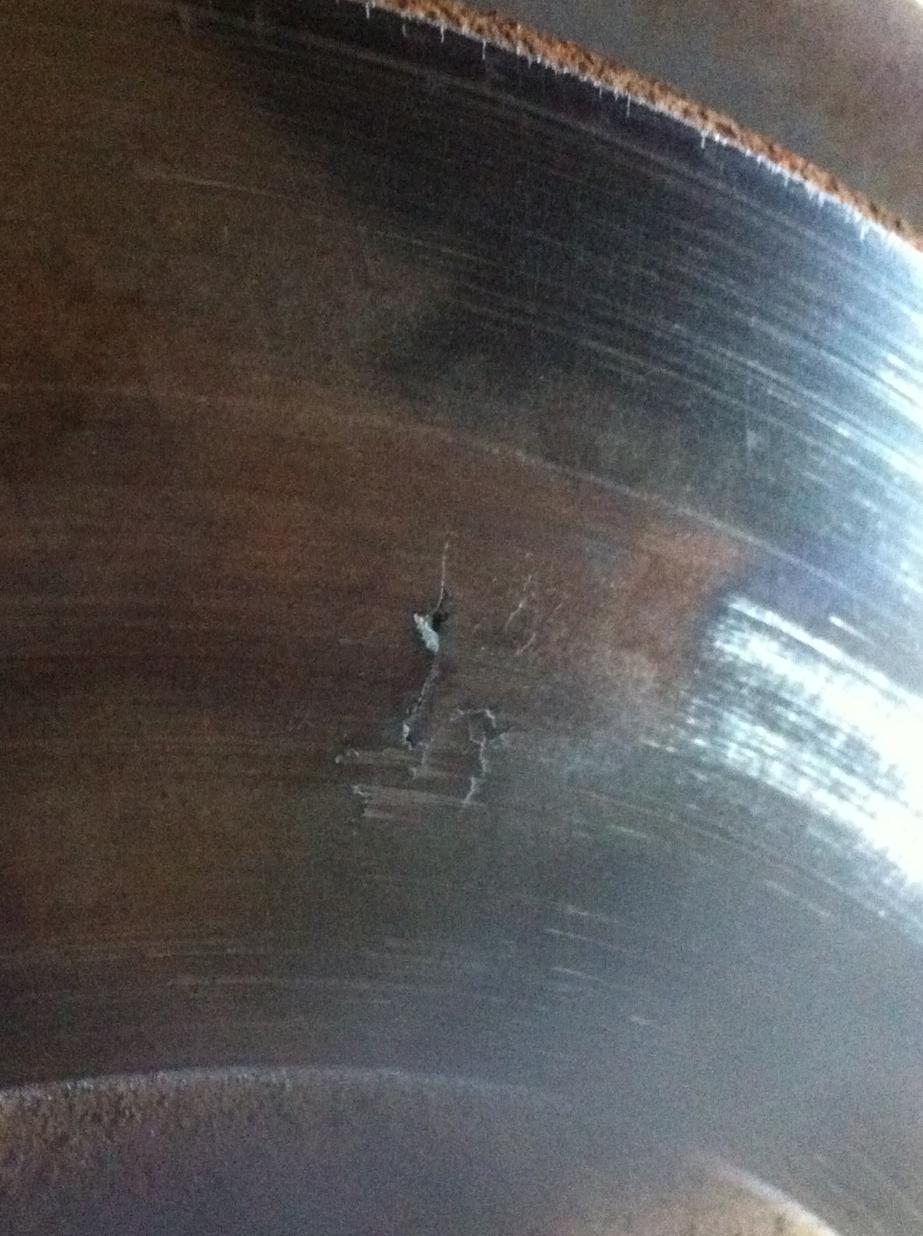

Front driver side. Do I need new brake rotors? Or can it be resurfaced? Any recommendations on new rotors (specific brands and models would be helpful? Slotted and drilled for better heat dissipation? Cheers.

What happened to this rotor to cause that damage?

I doubt anyone will agree to turn that one with the crack/hole in it, or that you would have minimum thickness when you are done. I personally would not even try.
But if you trust your shop and they say it's good to turn, turn ahead.
IanB: No idea what happened.

Doesn't look good to me.

But yes, judging by the photos, you certainly need new rotors.

Those rotors are probably way past the minimum thickness to crack/crumble like that. Probably chewed up your pads too. Replace with some blank Brembo replacements. No need for drilled/slotted on these trucks unless you really want it for looks.
Perhaps they are. I'll measure the rotor thickness when I install the new rotors. The pads are still looking good though.
