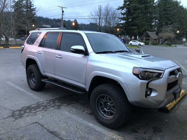

I installed the 2.5/1.5 lift from Dobinsons in my 2018 TRDOFP w/KDSS. I also added the thin Top hat spacers from Wheelers To add 5/8” lift to the front. Installed Dobinsons UCA too.
