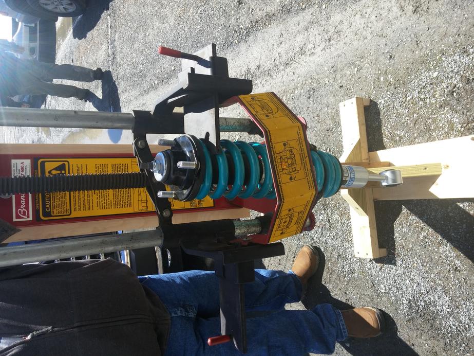

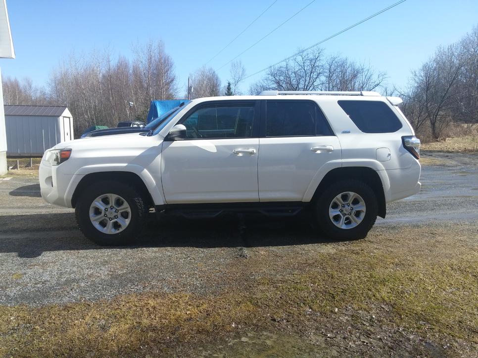

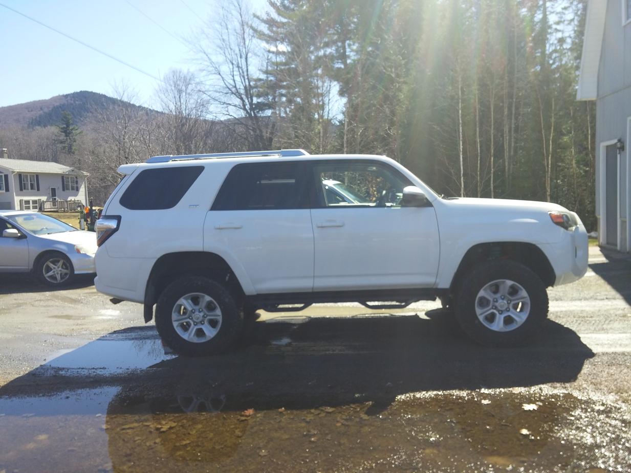

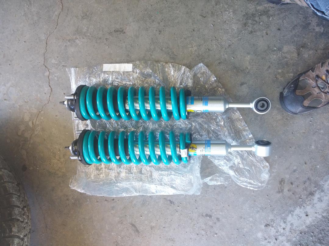

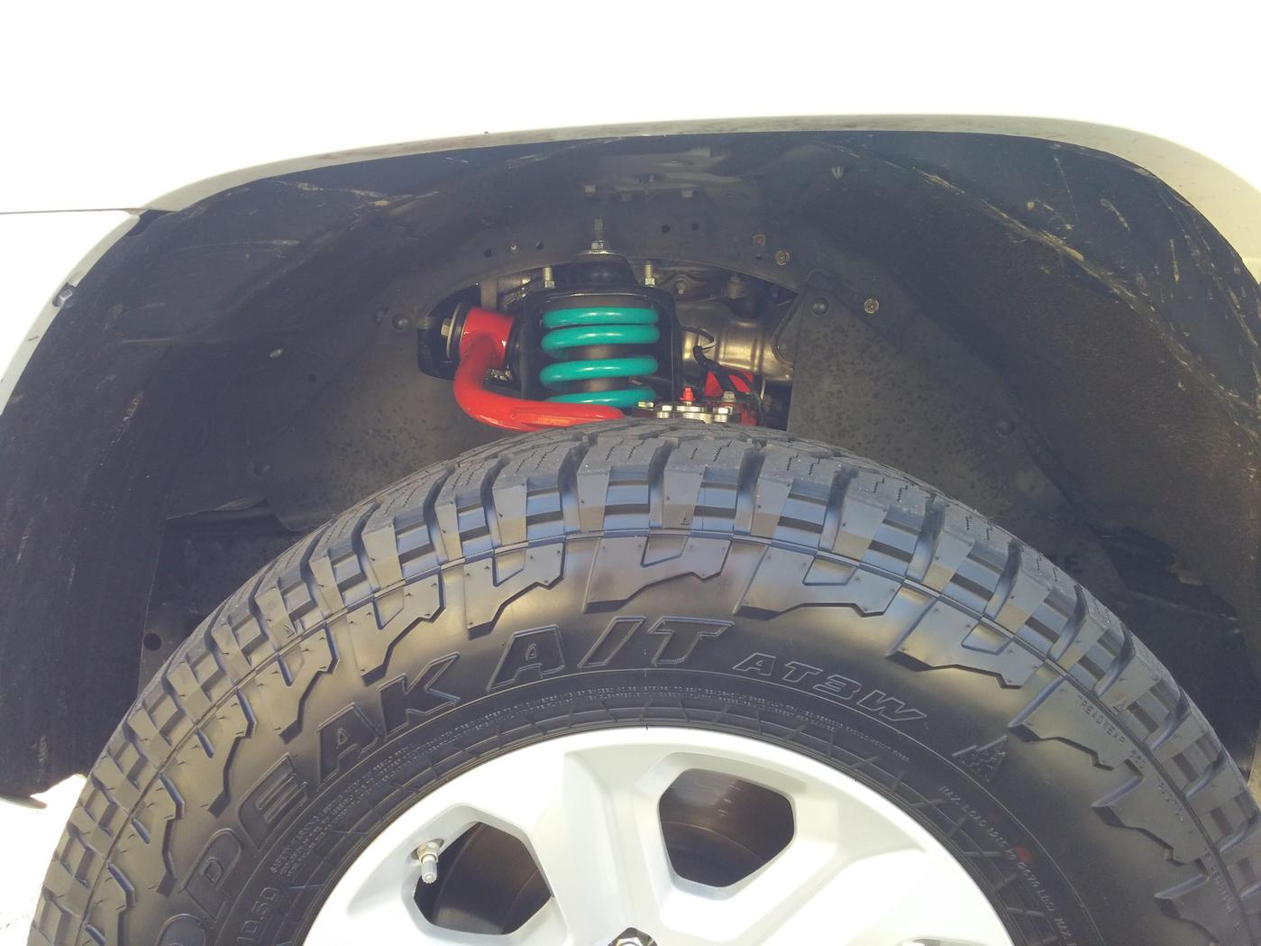

Finally was able to get my lift installed more then a week ago, and I am loving the ride. I went with the Dobinson C59-302 coils in the front and C59-325 in the rear, Bilstein 5100s all around, and JBA UCAs. I also bought KYB top hats so that I could pre-assemble the coils before installing. I had access to my uncles lift, and with help from my brother the install took use about 5 hours.
I was expecting the ride to be stiffer then it was. It feels much like the stock ride but with a lot less nose dive. I am very happy with the result. The only down fall was during all the excitement of the install, I forgot to take a measurement before the install. so I have no before and after numbers. Here are a few pics from the day of install. I am hoping to get some more pics soon when I have some time.

It looks good man. If you post up the measurement from the center of your hub up to the lip of the fender flare, front and rear, someone on here will have a stock one that can compare the measurements to, so that you can see the lift height.
The front struts are at the lowest clip setting?

Sorry to thread jack, but what size tires are those? I'm looking at the Wildpeak AT3/Ws and am trying to decide between 285 and 265s. About how much lift would you say you got out of the install? I know you didn't take exact numbers, but any guesstimate would be appreciated.

With stock bumpers front and rear, he should be at 2" lift on the front and 2" on the rear.

Yes I set it at the lowest setting. I think i may have checked 3 times on each side when assembling the coil over to make sure I was at the lowest setting and the cup was on correctly. I wasn't going to do it again! I had enough anxiety compressing the springs during assembly.
I am running the 265s. Wanted to keep gas Mileage close to stock tires. You will not be disappointed with the tires. I put an average of 400 Miles a week on these tires with about 15000 miles on the current set, and they are holding up very well. They are bit more noisy then stock, but not bad at all. Not sure where you live but these are great in the snow. Much better then the KO2. Makes for a great all year round tire up here in New England.
