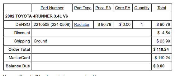

My '02 had about 140K miles when the trans cooler gave out. Turned a 2-3 hour job into a 2-3 day job. :ybrick: The replacement Denso radiator was $110 shipped from Rock Auto. I spent twice that in transmission fluid alone to flush it out.
