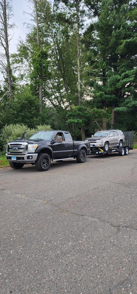

So the wifey calls me yesterday morning to tell me that she is broke down on the highway. She managed to get it off onto an off ramp half way up. I was just getting to work. So I leave and go home to get changed and get my F-250. I call my friend who has an awesome trailer and drive 45 min. to get it and then another hour to go rescue the wife. I get there and friggin' people coming off the highway onto the ramp are just flying by us with no regard for our safety. I was screaming and yelling but it made no difference. So I did my best to get her vehicle up onto the trailer as fast as I could sock it down with one strap and get out of there ASAP! Pulled off the ramp and found a sweet parking lot right next to the ramp where I could pull in and calmly finish securing the vehicle.
So she was driving down the road at about 65-70 mph and without warning the tranny just whined loudly and stopped any further forward movement under power? The engine runs perfectly but when you shift it into any gear NADA nothing no noise no shifting nothing. So I don't know what is wrong with this thing but it owes us nothing with almost 300K on the clock and probably the original transmission, plus it survived a strawberry milkshake years ago and continued working fine for another 60+K miles after I replaced the radiator and flushed the tranny out for over an hour.
So anyone know where a good place is to source a rebuilt transmission? Should I even attempt to rebuild it myself? I have done all the work on this myself and would say I am very capable but I have never rebuilt a transmission before and I know it isn't trivial. Any and all advice is very welcome!
