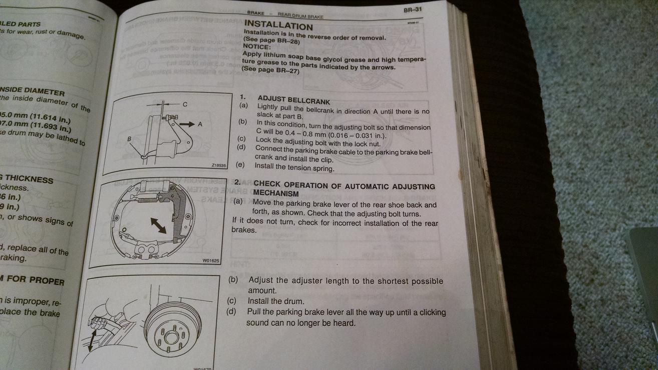

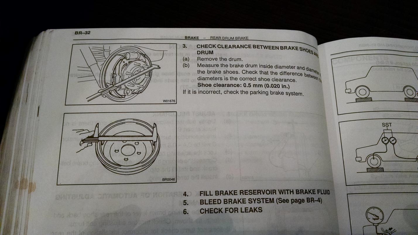

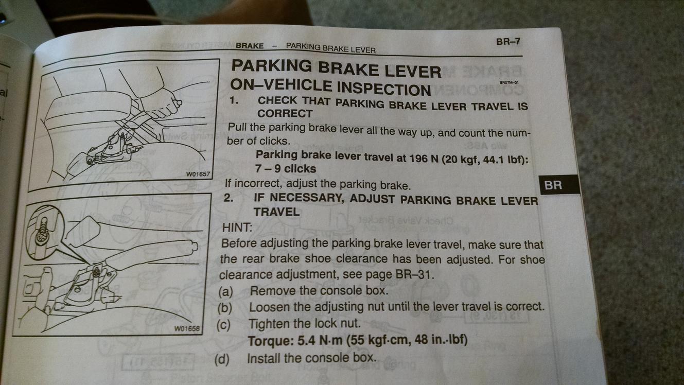

Maybe these pages out of my FSM will help.
