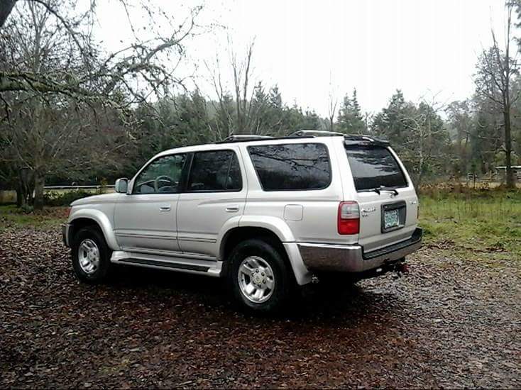

I'm not a bot. I just bought a 4runner. I'm still trying to figure out how this whole forum works... (as you can see I accidentally edited my post several times..)
I am also a total car noob with a vagina, trying to learn!
(Also, I was told it was the right/rear WHEEL CYLINDER not the axel seal, which I've been informed are different...)
Not sure if there's a way to private message, as to not clog up this thread.... but if anyone has info they are willing to share, let me know!

You mention you have a vagina... so you must be a female... but i have had the pleasure of meeting males with vaginas.... not literally.. but figuratively. So no matter what you have, don't sell yourself short. Anyone can take on car repairs. & you are correct... the wheel cylinder going bad is also something that can happen... IF your wheel cylinder went bad that is a MUCH easier repair than the axle seal.... basically you just take off a wheel, then your drum & have immediate access to the wheel cylinder .... the axle seal requires you to drain your differential & then remove the entire right or left side axle... I would say you're lucky if it was just your wheel cylinder.
