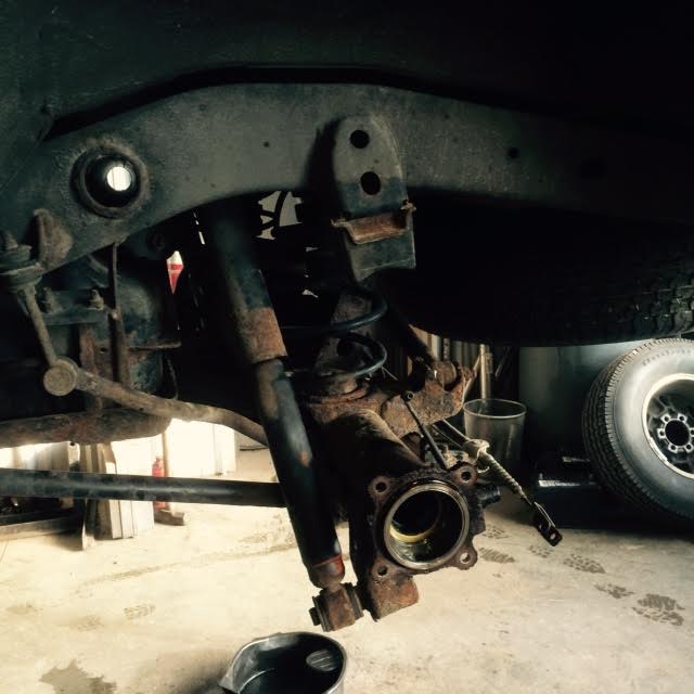

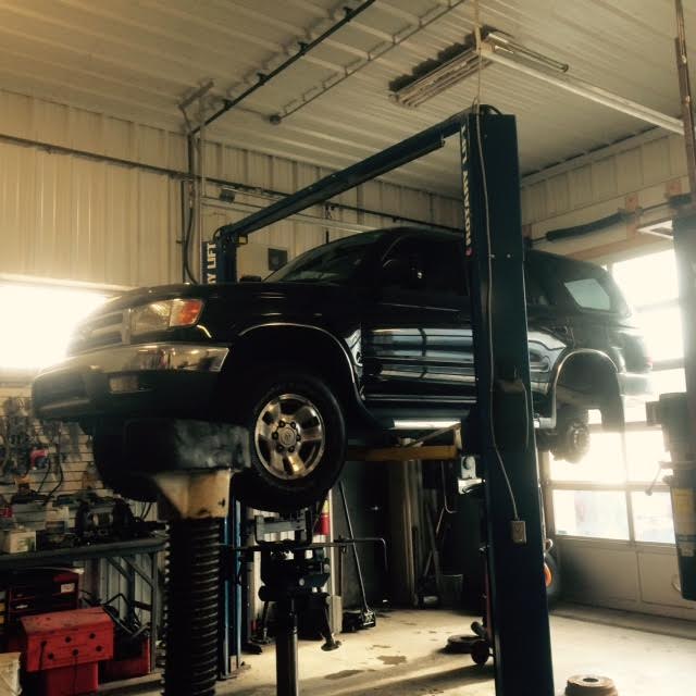

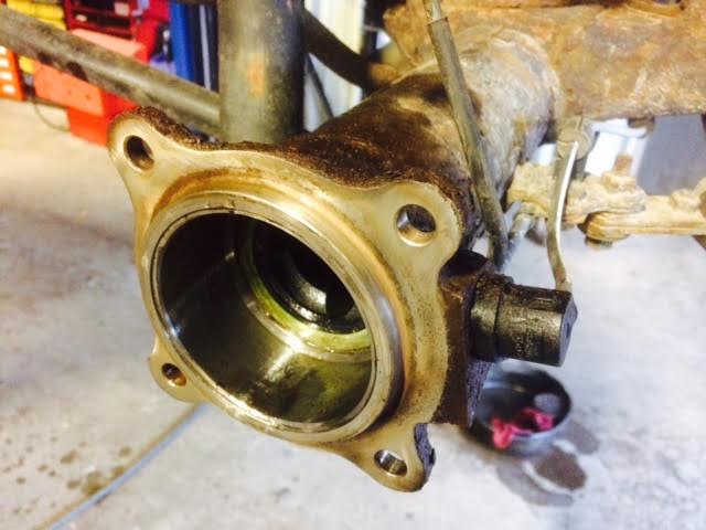

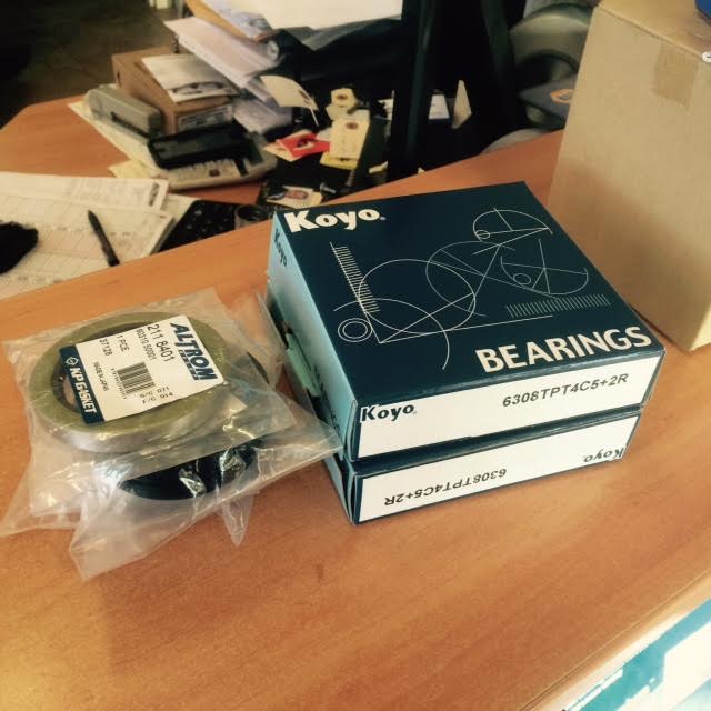

When I bought my 2000 SR5 from a close friend with garage & dealer licence, the agreed purchase price included Govn. Safety check & E-Test.
- once it got on the hoist for inspection, the rear axle seals were leaking
- my 4Runner was low miles (89,xxx miles / one senior owner) and always maintained at a Lexus/Toyota dealership
- his top mechanic is retired from Army, so his workmanship is stellar
- when the axle's were pulled, mechanic found leaking axle seals installed wrong
(so appreciate your write-up)
- ABS rings damaged during removal, so new ones ordered from Toyota
- quality OEM seals & Koyo wheel bearings (made in Japan), also installed...no white box China-crap parts
- ceramic brake shoes, spring hardware kit & maybe a wheel cylinder (or 2 ?) completed the brake task
I got lucky, excellent & complete rear axle repair work was performed, at no charge.
