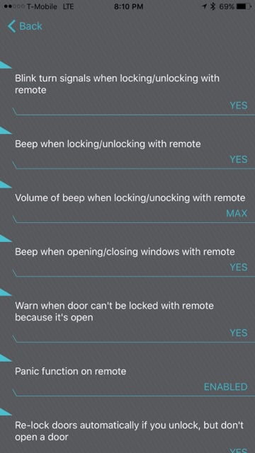

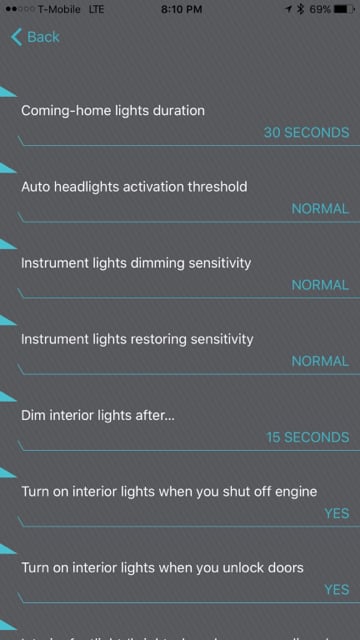

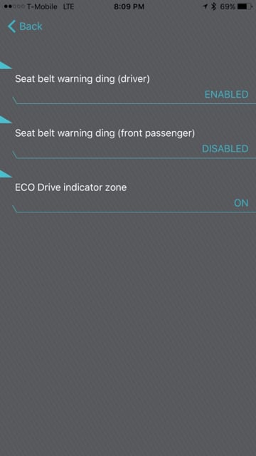

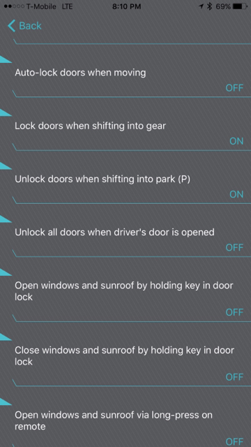

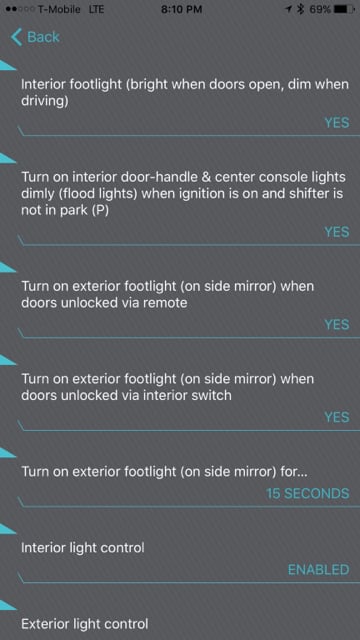

I just received the carista module today and have only started to use the paid app for it but so far so good. I just turned off my seatbelt chime and took a few screenshots of other options you can change.

Does it let you disable the stupid seatbelt chime? That is all I really care about. The rest is icing on the cake. Stupid dealers will not change the setting, claiming legal liability. I'm an adult and an American, I dont need or want the govt telling me how I should be reminded to put my belt on, or much else for that matter.
did you even look at the pictures posted...?
I did. That was followed by the comment that some settings took and others didnt. I wanted to know if the seatbelt chime was one that actually worked.
I'm interested in this also. Particularly, I want to know if the "Windows and Sunroof open" option works if you hold the unlock button. Had that in an Acura and thought it was cool.
So I have confirmed the seatbelt chime is off. The wife swore I was trying to kill her when I told her to take off her seatbelt while we were driving in a parking lot so I hope you are all happy. I'm gonna try the Windows tomorrow and report back.
So I got it all working. Windows down with remote long press and windows up and down with the key in the door. I don't have a sunroof so I can't comment about that but pretty safe bet they are all tied to the same system so it should work.
All functions work in Carista, so if you see it, they should work, so long as you have that option (such as having a sunroof, etc).

Ah the ever-so-elusive "Interior Footlight"
So far I have only found one car in Toyota's lineup that has that option... a Rav4 (LC must have it too)

The Windows down feature with the unlock and lock buttons.....
Is that only with the smart remote or does this work for the regular remote as well?
It works on the standard remote, I have it working on my SR5 model. Just wish you could put it up too, but that's not an option, aside from putting the key in the driver's door lock and holding it.
