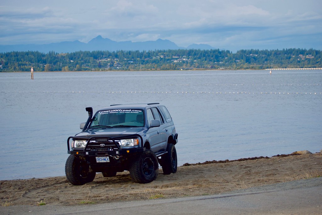

That is a very difficult thing to quantify but from personal experience, running a wider track and heavier (wider) tires makes a very noticeable difference in the handling of the vehicle. The tires are the lowest point on the vehicle so while added rotational weight has a whole list of negative side effects, one positive trait is that they will lower your center of gravity. I ran a set of 31" winters with Tacoma wheels with the 5.25" (?) backspacing last winter and the handling suffered substantially.
I don't think 4.5" backspacing wheels (I assume 8" wide) on their own will make a huge difference over the stock wheels, but combine that with wheel spacers and/or heavier tires and they will.
But enough about all that safety stuff. Don't forget the most important part: Wide tires just look mean!
P1090259 by Brandon Faliszewski, on Flickr
