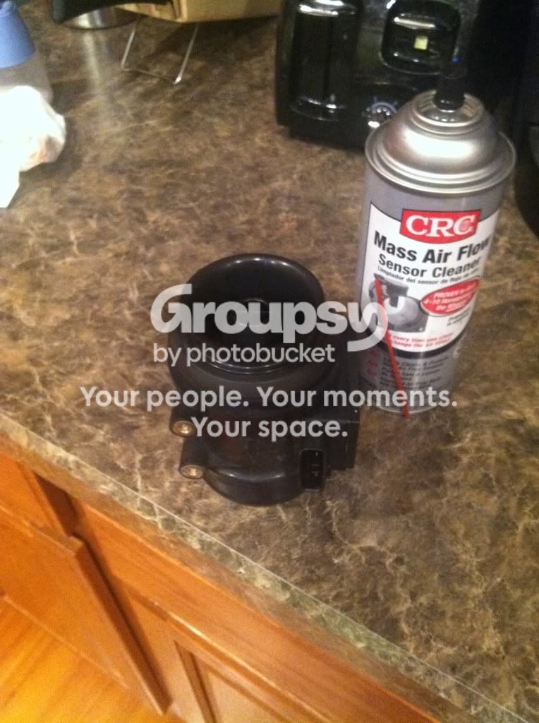

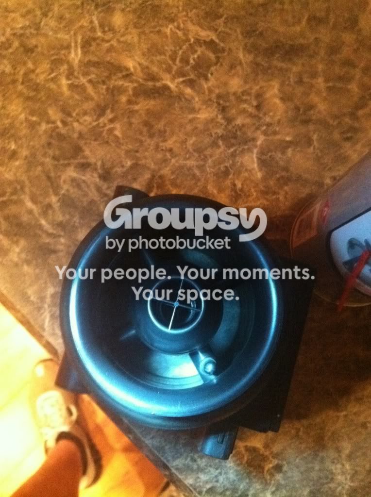

So I spent some time trying to figure out my horrible MPG issues today to no avail. I took a break and was poking around T4R and came across a thread about cleaning the MAF. I've already done that but in this thread Durk posted a pic and the MAF was actually apart.
Here is mine and this is how it was was I sprayed it out with CRC MAF Cleaner.

If it does come apart, how do you disassemble it? I don't want to break it but if I can take it apart to clean it better I will.

I know yours is a 97, so it might be different, but my 99 has a small square plate with two screws on opposite corners that pulls out of the intake tubing. My 03 Tacoma is the same. Attached to that small square plate at a perpendicular angle is a small sensor in a housing that you can spray. I'll see if I can find a pic-
no tommy it doesn't. if you want to get at the element, you have to stick the cue tip way down in there GENTLY! carefully swab back and forth with a little maf cleaner on the cue tip and you're done. just make sure you drain the excess cleaner out of the element housing.
Thanks guys. I just sprayed it a few times again and I have it sitting upside down with a little MAF Cleaner soaking in the element right now. I'll let it sit for a few, drain it, give it another spray out and then let it dry out for a while. I concentrated on the wider "air tube" part of it when I cleaned it before.

I used non-chlorinated brake parts cleaner to clean mine, shot directly at the diodes inside the MAF. At first I shined a light down it to see what I was looking to hit and saw to vertical brown blobs. After blasting each diode individually I looked again with a light and saw two shiney flat metal pilars that looked like they could actually sense something. Ive never used specific MAF cleaner and dont know how it dries but I can vouche for the brake parts cleaner and it was money.
On a side note, after cleaning mine (the new MAF version) I cleaned a co-workers whose looked like yours. The diodes were not as accessable as mine but was still simple enough to clean effectively.
No because I kept reading warnings about not touching the contacts. I actually soaked it for about 30 minutes though, it looks spotless. It's a lot cleaner than it was before. I feel like an idiot for just cleaning the plastic before.
