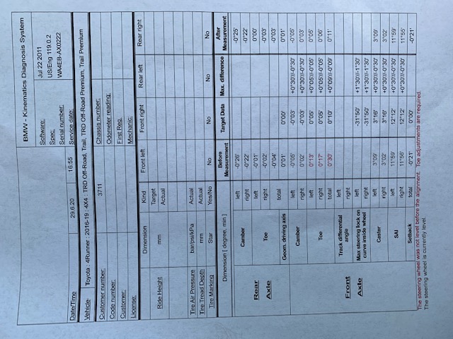

Could not wait until Thursday for the shop to call me. I work at a dealer and I had my front end guy do an alignment and balance all 4 tires again. He said alignment was slightly out but not too bad.
When he balanced the tires 1 tire was missing 50g, another 100g and another 165g. Drove the 4runner home yesterday and its riding the same (pulling to the right) but now is vibrating even more. He's going to check road force today, and possibly swap the tires to see if its a tire pull.
Attached is the alignment sheet from yesterdays alignment.
Hopefully this gets sort out soon :(

What I see missing is cross caster. For areas with more crown in the road, you want more caster on the RIGHT hand side than the LEFT hand side by about 0.2-0.3 degrees. That will cause a slight pull to the left that will offset the tendency to drift right on crowned roads. Have them set the right hand side caster to around 3.2 and the left to 3.0. I think it'll go a long way to helping resolve your issue.
good luck
What I see missing is cross caster. For areas with more crown in the road, you want more caster on the left hand side than the right hand side by about 0.2-0.3 degrees. That will cause a slight pull to the left that will offset the tendency to drift right on crowned roads. Have them set the right hand side caster to around 3 and the left to 3.2-3.3. I think it'll go a long way to helping resolve your issue.
good luck
Wait. Unless I'm reading this wrong, he would need more positive caster on the passenger side to fight the road crown compared to the driver. That's always been my understanding of it anyhow.
Yep. You're right. I had it backwards. More caster on the passenger side. Glad you caught that.
